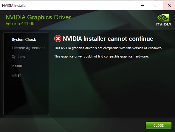

Adobe Premiere Pro 2020  was giving me the dreaded "System Compatibility Report" message. I followed the link provided under the "Fix it" option to download the latest NVIDIA drivers (v441.66 at the time), but the driver installer would fail, reporting that "The graphics driver could not find compatible graphics hardware".

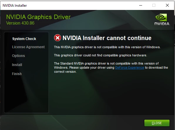

The link took me to the same NVIDIA driver download page as before, but this time in desperation, I searched for older versions of the drivers. My hope was if I downloaded driver version 430.86 it would solve the problem even though it was not the most recent version. While the older installer also failed, it was kind enough to also tell me that "The standard NVIDIA graphics driver is not compatible with this version of Windows. Please update your driver using GeForce Experience to download the correct version" It even included the link.

Solution: The full download of NVIDIA reference drivers (or my version of Windows, 10.1903 Home x64) does not support the GeForce MX150 GPU on this laptop. In order to get newer (and supported by Premiere Pro 2020) drivers, you must install the "GeForce Experience" app:
https://www.nvidia.com/en-us/geforce/geforce-experience/
Screenshots of error messages:
