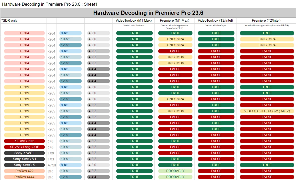

I don't think this is a huge deal, but people have been asking me which codecs have hardware decoding support in premiere. In testing, I found a few bugs where certain bitrate/codec/chroma-subsampling only works in MP4 or MOV containers. I also found some hardware decode support that is being software decoded in premiere. Obviously some of these combinations like H.264 12-bit 4:2:2 are too random to actually come up in the wild, but others like 8 bit 4:2:2 might be more common. I'm not sure!
Here's my testing: https://docs.google.com/spreadsheets/d/e/2PACX-1vTqbtmYpBX_eRtHPbFh5oLRSn_u6NFwgv2XYRDurfvtV6HrOjLrHT6BkxjEP4Eyg0D9-LJgcG9cP47d/pubhtml

thanks @mayjain7130546 for getting to the bottom of those MP4 files!
I went through and fix both the spreadsheet and the folder of test files and verified that they are what they say they are.
So it seems that for the most maximum compatibility (say for making proxies), premiere is well optomized for H.264/8-bit/4:2:0, H.265/8-bit/4:2:0 and H.265/10-bit/4:2:0.
Other overvations:
- H.265/10-bit/4:2:2 also is well supported but I'm not sure what "Videotoolbox SW" means in the debug tool for the iMac Pro with the T2 chip. Is this hardware or software decoded?
- H.264/10-bit/4:2:0, H.265/8-bit/4:4:4, H.265/10-bit/4:4:4, H.265/8-bit/4:2:2 are all well supported by the hardware (and also the first three by Nvidia) but chosen not to be implemented in Premiere. Understandable because they're pretty niche combinations.
- Still no idea why my XF-AVC, 10-bit, 4:2:2, Long-GOP footage from my C70 isn't hardware decoded. Not sure what's different about long-gop versus all-intra that would effect this. H.264/10-bit/4:2:2 is normally supported and the XF-AVC version shouldn't be much different. Footage example in the folder!

Hi @jefftypebeat ,
Thanks for the details. I had a quick glance on the test files you shared and found that 422 10bit mp4 files are actually 422 8-bit files. I believe you will certainly notice HW decode with 422 10bit mp4 files. Please have a look.

thanks for looking into this @mayjain7130546
1. Here are all my test files: https://shared-assets.adobe.com/link/62dbcbbe-0203-44e8-5e08-e7a62f8c3cb4
These were created using ffmpeg and libx264 and libx265.
2. Link above has every clip in both .mov and .mp4 container.
3. You are totally right. I checked this again on the M1 Max machine and it Hardware Decompressed frames went up under importer.MXF. Correected on the spreadhseet. Photo here: https://share.cleanshot.com/8xwD50Rxc3kGH6gJcLsj
4. I put probably because I wasn't sure how to check for prores hardware decoded. Is there something similar to importor.MPEG? I have no reason to doubt this feature works as advertised.
5. In the IINA inspector it shows if a video is using the hardware decoder. See here: https://share.cleanshot.com/Bc6tyhFynDqsBDGMYKBJ and here: https://share.cleanshot.com/WpYvwHt2YKmlGR64qrmw
Appreciate you looking into all this!

Hi @jefftypebeat ,
Thanks for your detailed report and highlighting your doubt. Regarding your observations on M1 Max, I have a few questions:-
1. As added in the sheet, 420-10bit/420-12 bit(H264) & 420-12bit(H265) media types are showing HW decode only for mp4 files. Did you try creating the test files in mov ? Can you share these test files ?
2. 422 10 bit files were HW decoded only for mov. We believe it should work with mp4 also.  Can you share the test files where you didn't see HW decoding ?
3. Sony XAVC I is mentioned False. We believe these files are mostly in .mxf container and they should be HW decoded. Please share some media where you didn't see it working.
4. Are you not seeing ProRes422/4444 files being HW decoded ? The details show 'Probably'.
5. How are you concluding with IINA that files are HW decoded ? Is it by disabling/enabling Hardware Decoding checkbox under video panel and checking CPU/GPU usage from Activity Monitor ?
If possible, please share your test media files https://helpx.adobe.com/creative-cloud/help/share.html so we can investigate the file types quickly and update you accordingly.

Neither Nvidia nor AMD supports 4:2:2 hardware decoding at all no matter what. And Adobe has chosen not to implement 4:4:4 hardware decoding support on Nvidia GPUs (AMD's hardware decoder supports only 4:2:0 no matter what).
That leaves only Intel GPUs (either integrated-on-CPU or discrete) which support 4:2:2 hardware decoding. Please note that only the 11th-Gen or newer Intel CPUs' integrated graphics processors and the discrete Intel Arc graphics cards support 4:2:2 hardware decoding for HEVC.
As for 4:2:2 H.264. you're out of luck. Nobody supports hardware decoding for that format. Only 8-bit 4:2:0 is supported for H.264.

This would take folks like @Fergus H and/or @RjL190365 to sort out.
The table of his link is this:
