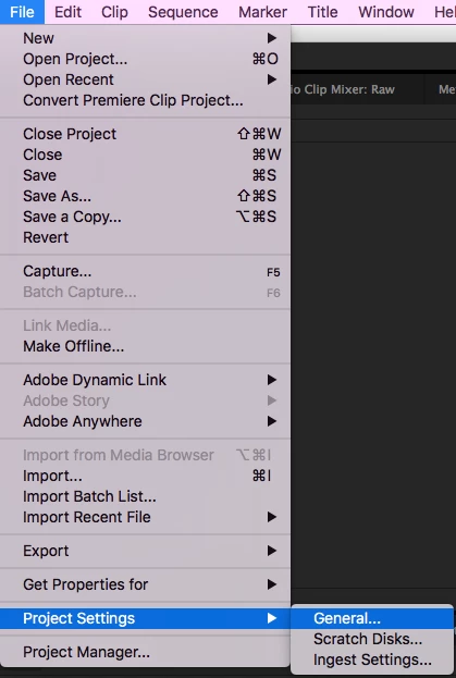

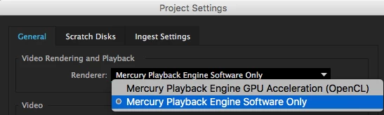

Steve, two things: 1) go to File > Project Settings > General... and then changing the Mercury Playback Engine Software Only... 2) then delete all stored Previews from your Media Cache. I am not sure which of these two cause the biggest problems, but I've dealt with this problem for years and these steps seem to have taken it away!

My problem is solved by going to File > Project Settings > General... and then changing the Mercury Playback Engine Software Only... then deleting all stored Previews.
