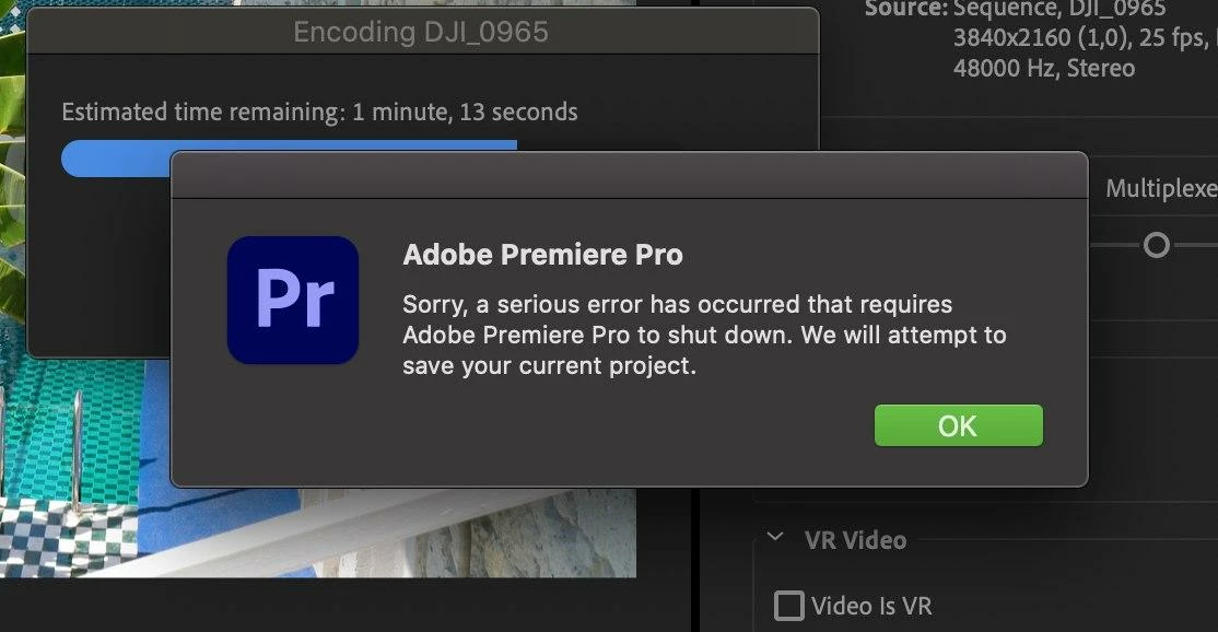

Hi guys, help me solve the problem, technical support could not help me with this issue! Every time I try to use graphic templates the program crashes with this error.
I do not understand what could be the matter, I tried to completely reinstall, but nothing helped

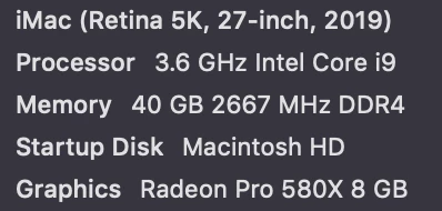

My PC

upd 1: In this case, new details surfaced, the day before yesterday the adobe technical support service tried to help me with this problem via remote access, but absolutely in vain, in the end they said that since the standard adobe templates work, and the rest do not, then it's not the program, but in templates, this is where my conversation with them ended.
upd 2: I completely uninstalled all adobe applications and using the adobe creative cloud cleaner tool completely cleaned and reinstalled all the programs I needed, the problem persisted, and then I decided to do downgrade, I reinstalled the program to the old version 14.0 and all the templates worked,
So adobe, I conclude that it's all the same in your program, not in my templates, it can't be that 1000 templates from different sources give the same error when trying to use it, I hope that you will fix this defect with the next update.
