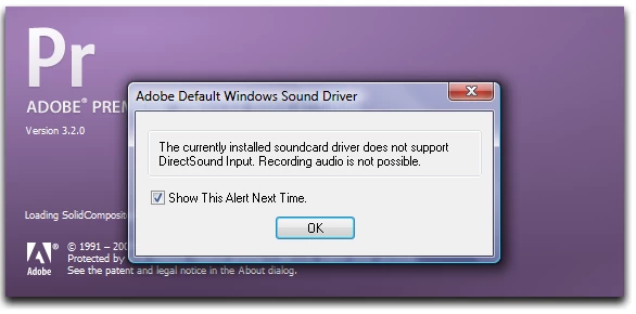

Sound Card driver does not support DirectSound input
This is problem A.

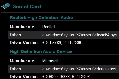

The souncard I have is as follows:
I have been to device manager/audio hardware to update the drivers but get the response that they are the latest drivers... (They should be as the computer was purchased a week ago (July 2009))

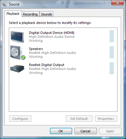

    Let me first show you the hdmi thing I was talking about in my second post. Notice the Digital output device(HDMI), which came back, versus only two devices from my second post.

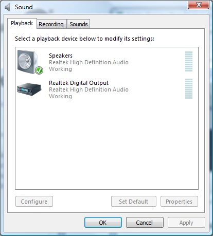

    Thanks for all your post's I tried disabling the digital and HDMI outputs in playpack (thinking I could easily get them back) but could not find how to get them back. I tried going backwords using different restore points using windows system recovery. At each restore point windows ended up not being able to do the restore. In the end I deleted the driver completly in device manager. When the computer rebooted the driver reinstalled itself. The digital output reappeared   the HDMI output did not  (see screen shot) when I opened premiere I no longer got the error! I will try to figure out how to get the HDMI back if I ever get an HDMI monitor. I am happy everything is working now and can get on with trying to learn Premiere. Thanks for all your help!
