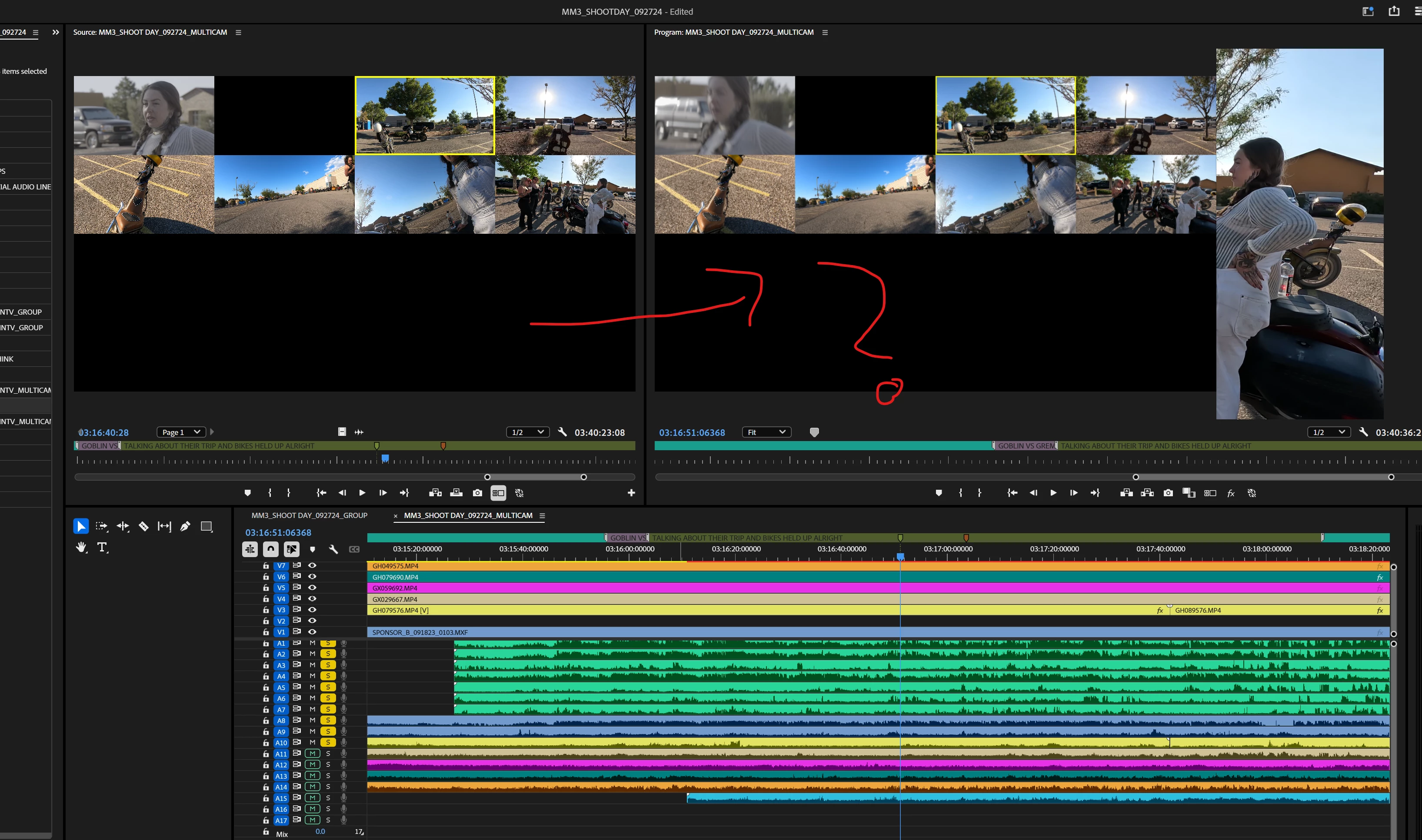

Both source and program monitors are behaving oddly during playback as if a glitch or bug, I'm not sure what. What it's doing is creating a mirror image of itself on either side of itself, consistently but at random times throughout multiple projects. Like a ghost that will not stop haunting me! hah.
For example, if I've loaded a multicam to source and hit play, sometimes I suddenly see a duplicate of the same source window (with obviously multiple angles of footage in multicam view) over where Program monitor is. It doesn't entirely cover it, just most of it. And begins to act laggy and strange when this happens and tips you off something is going wonky.

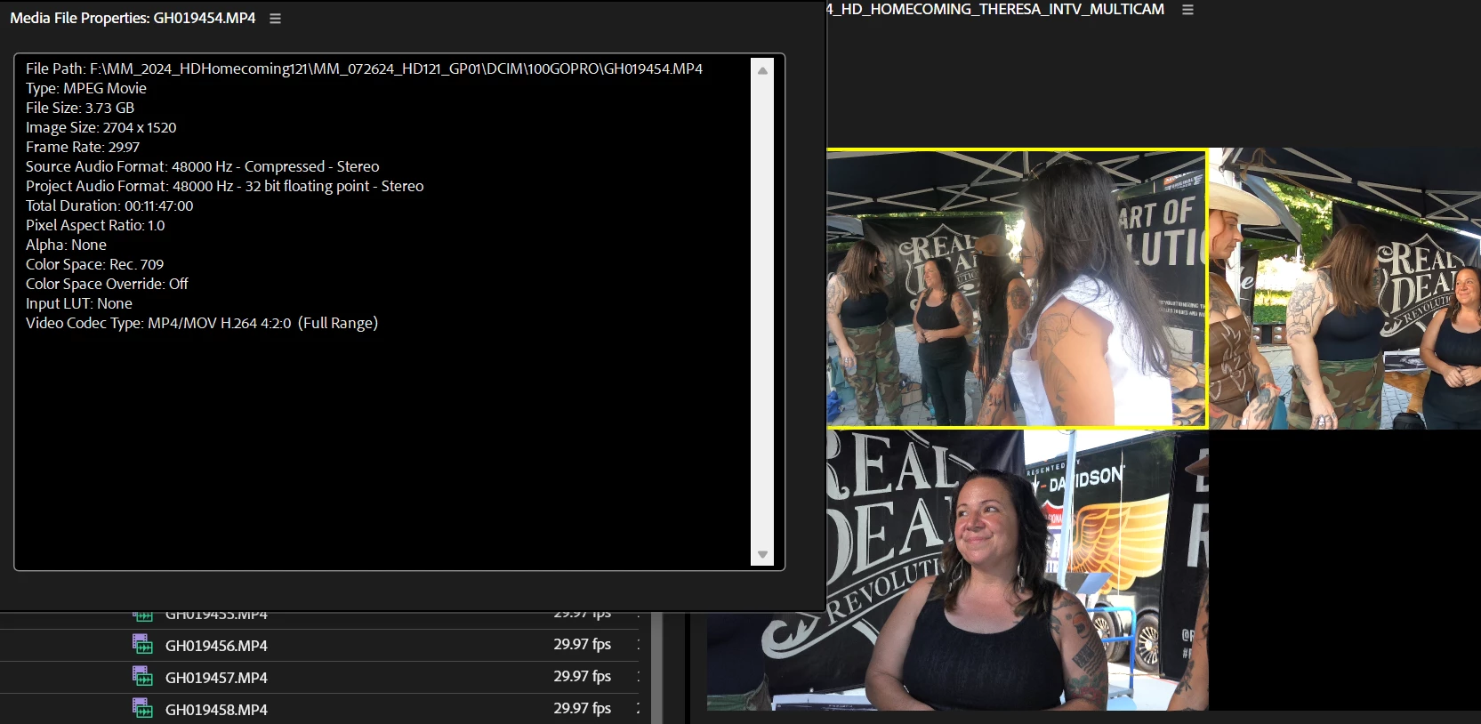

This admittedly might be trickier. I've created dozens of multichannel multicam using go pros and a main A/B cam angles (Sony FDR-AX100, can include a clip if you need!) but it's even doing it just with gopros stacked so camera doesn't seem to influence it.

Because we tend to load our multichannel multicams into source, this happens the most for me in Source playback, but occasionally with Program playback from timeline. When I'm playing direct from timeline to Program monitor, it'll mirror to the left now over where source window hangs out. The Source/Program monitors are side by side per usual in my layout by the way, so you can picture what I mean when I say to the left or right, and included a screenshot.

I've attached everything I could think to send including the entire project, screenshot of it doing that mirror thing as described, a very overtired phone vid of me capturing it doing it live, and a quick spec on the actual footage for gopro and the Sony FDR-AX100 clip.

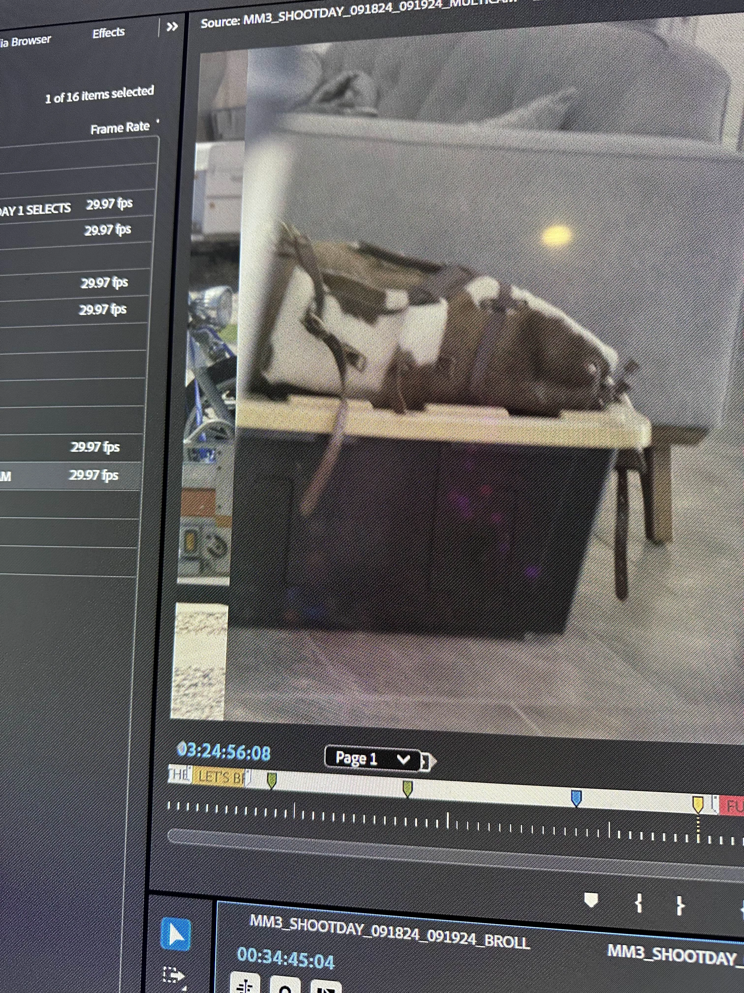

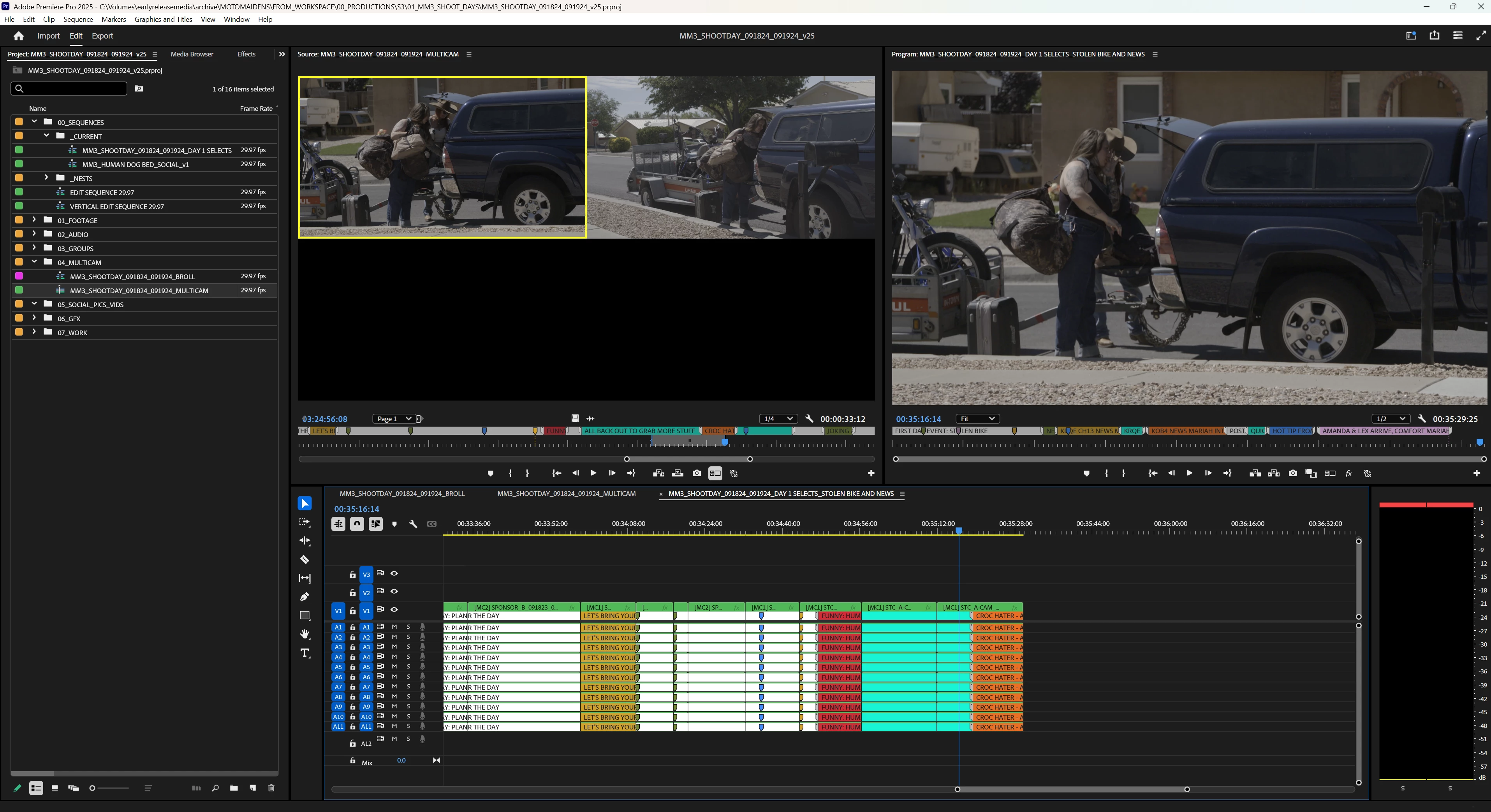

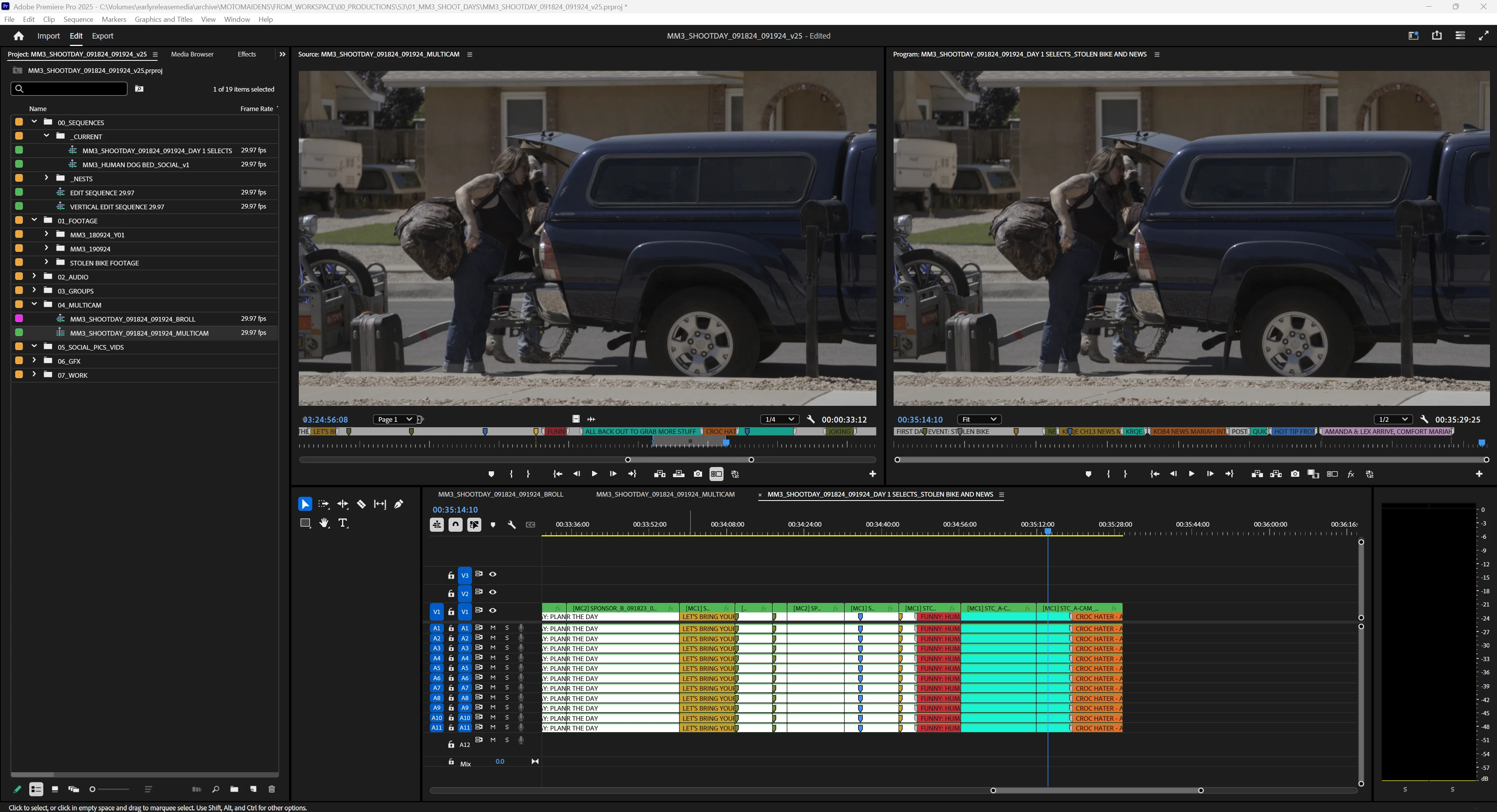

Thanks again for checking in Jamie! So it's happening and I'll try to explain what was going on while it did. I was playing back from my selects sequence timeline which shows up in Program normally. The source panel just looks like I've loaded that same shot in, but I didn't and instead should contain the multicam sequence loaded there. See my screenies.
Program mirrored over the Source Panel this time. It had what I can best call a 'screen tearing' on the very left end of the mirrored Program video playing over Source as if it wasn't fully there copying it, which you've maybe seen already in my attached vid from initial report since I captured it live playing back.
When it happened, I went to use the snipping tool to take screenie, and it's as though Premiere refreshed during me clicking and back, which is why it looks "fine" like a clip loaded to source. I even tried my shortcut screenie command but that seemed to refresh it too. Went ahead and moved the scrubber again, still there, only this time I took a phone pic to more clearly highlight and retain this 'screen tear' I mentioned. Sometimes it's a small one like this, sometimes 1/3 of that panel is see-through past the glitch thing.
I feel like it's related to something with how things are refreshing? Somewhere? don't know how or why exactly or if I'm just cursed lol? Hope that makes sense.

here is how it should look:
Here is when it did the mirroring from the Program panel over my Source, no tearing but still wrong, the left source side should have the multicam from my other screenie:
Close up of the 'screen tear' type thing I described via my phone so it wouldn't refresh and look "normal":
