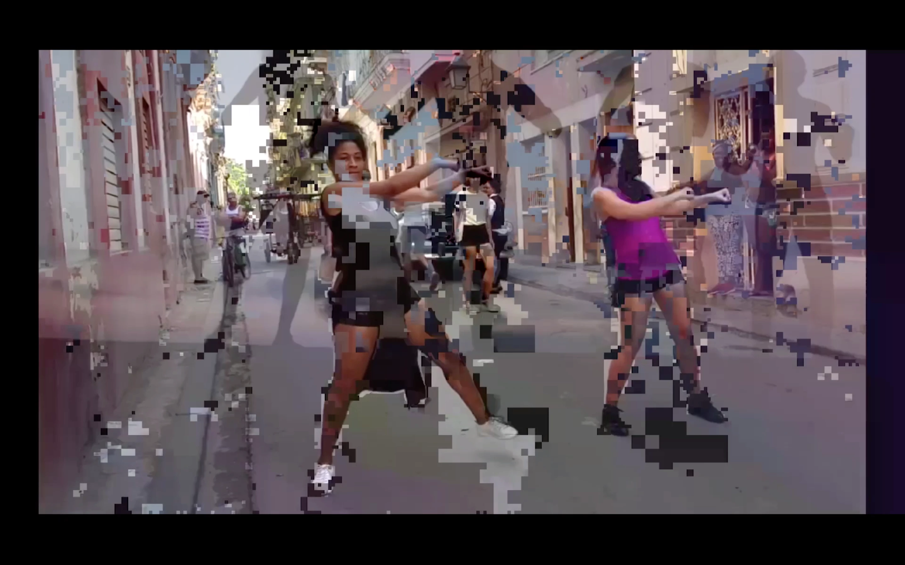

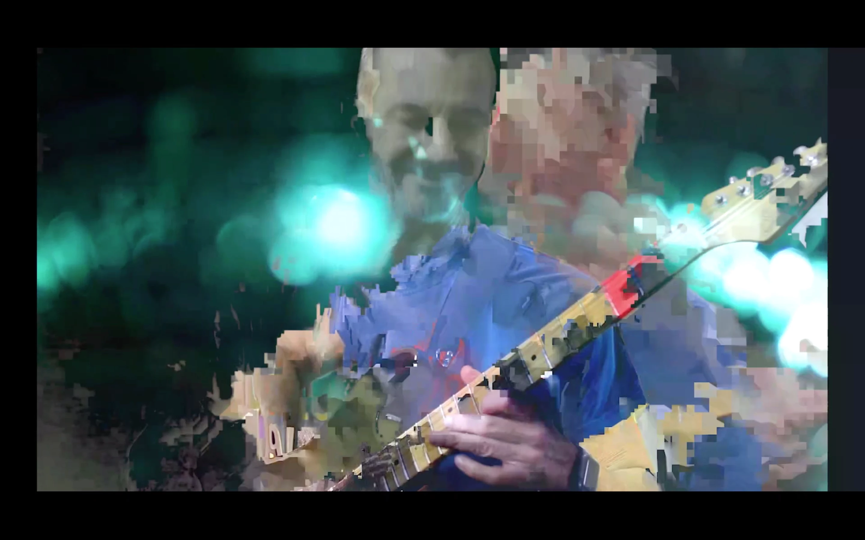

Hi! I have noticed sporadic errors including sudden pixalation (pl. see example attached) after export of a music video - these errors are not visible when I play the video session in the time line in adobe premiere pro (14.7.0). It seems that there is an overlay of two clips but there is actually only one clip at the time of interest in the time line?! The export was performed with H.264 format (1920:1080) - the errors did not depent on render quality settings. I had these problems before indicating that I likely make any systematic errors? Tx in advance!

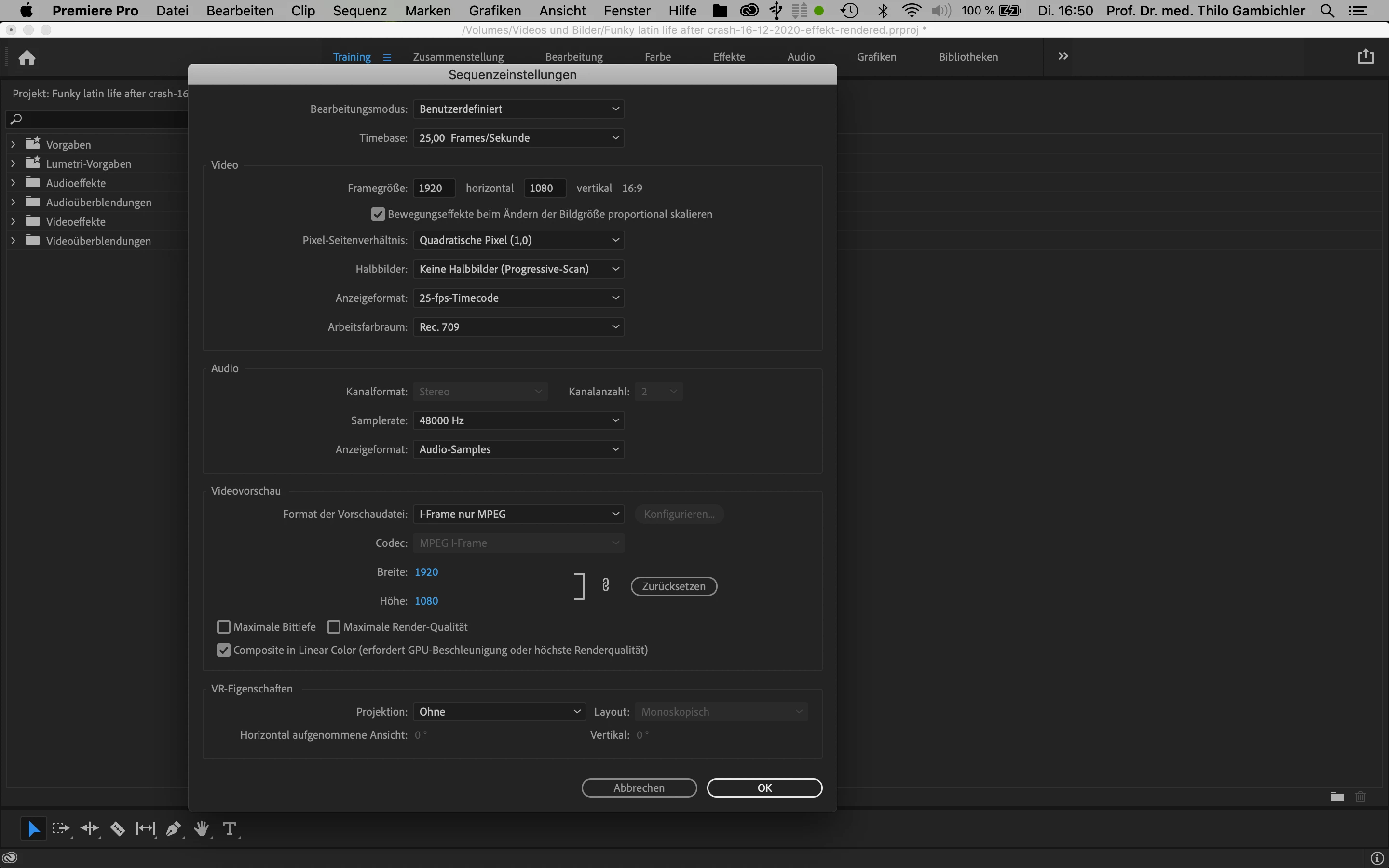

December 27, 2020
these errors do also appear when I set MPE to software. I am using a MACbook pro (mojave 10.14.6, 2.3 GHz intel core i9, 32GB 2400 MHz DDR4) equipped with radean pro vega 16 4GB and intel uhd graphics 630 1536MB. Which driver must be up/down-graded?

Thanks for your request - perhaps you can already see the problem  in a screenshot. These artifacts lasts for about a quarter second.
