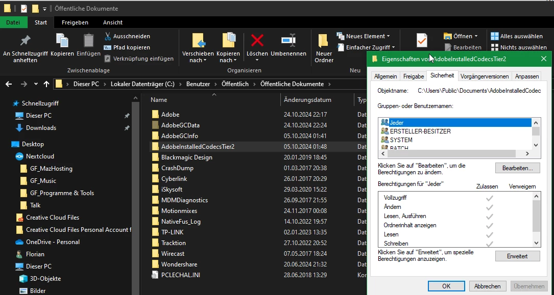

PlerTanixAuthor
October 24, 2024
I have read-Write Permission:
Which user need read-write permission?
jamieclarke
October 24, 2024
Hi @PlerTanix
Make sure proper read-write permissions are granted to:
C:\Users\Public\Documents\AdobeInstalledCodecsTier2 folder.
Can you try that?
See also this document for how to change permissions for other crucial folders: Preferences folder read-only error.
