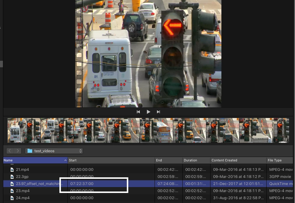

FCP
Time code of first frame                 : 07:22:37:00

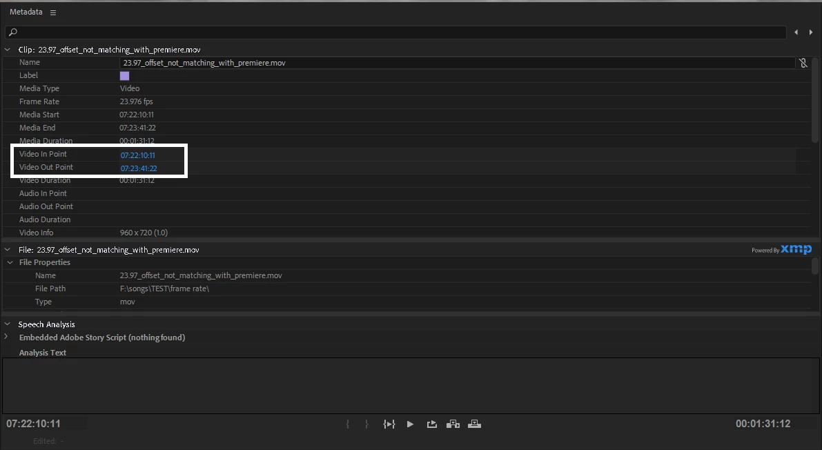

Premiere pro
Time code of first frame                 : 07:22:10:11
Is it a bug in Premiere? Or do we need to do some preference changes?
