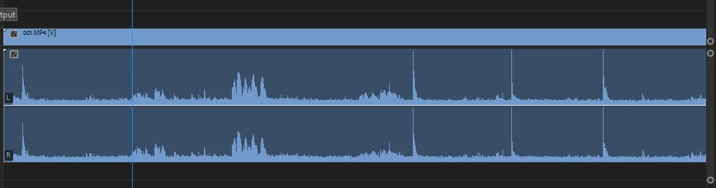

How obviously audible is the stereo effect? I have always used a mono shotgun mic up until now,and have just bought my first stereo mic.
I was expecting a LOT more stereo separation than I get.The waveform below shows the sound that is recorded onto a digital camera that is set up in the middle of my back garden pointing across it.The garden is about 25 feet long and I walk along it speaking at one end of it,in the middle and then at the other end of it.I then do hand claps in the same places.
Under these conditions (no reflections etc),I'd have expected much more obvious left and right placement of where my voice was coming from,but even on headphones there seems to be almost no separation at all and the waveforms are almost identical mirror images.
Is this as good as it gets straight out of the mic without any processing,or are the exagerated stereo effects we hear in the cinema and elsewhere just the result of processing,i.e. do I have to to use the panner control if I want something to move realsitically across the sound stage?
It's main use will be for motorsports,so it would be nice to hear the car move across the soundstage as well as see it move across the screen.

very ingenious of you .. you discovered 'room tone' ( what you call noise )..and used it to make it sound better when panning ...
You might be able to get what you want with a subtle volume adjustment on the left and right tracks...as car moves left you increase the volume ( key frames ) slightly on the left but leave the right alone. It might be just enough to give the impression you want.
I don't know how you came up with 100 meters apart stuff.... the H4N has 2 mics inches apart from each other and it does record stereo. For about $ 250 or so that's what I would use if doing what you want a LOT.  Just to be faster getting it done. You can mount it on something and just aim it toward what you're shooting ... with a slate if you can handle that ( for sync ). Sometimes you need to run around a lot if by yourself to do all this stuff ( roll sound, roll camera, mark it ( slate ) run back to camera and focus, frame and shoot.

The 100 meters apart comment was supposed to be a joke.I understand how modern music is multi mic'ed with studio recordings where the musicians are in separate booths in a lot of cases,so the recording engineer can place any instrument where ever they want on the sound stage.My expectations were based on a single stereo mic pair being used to record a whole orchestra that gave accurate stereo placement of both left and right and front and rear of every sound source in front of the microphones.
I've yet to use my new stereo mic at such an event.But from what use I have had from it so far,it's ability to pick up at the sides a lot more might be a hinderance rather than a help.The shotgun mic I used on the following clip would probably be better for this type of usage.
This was done simply enough with keyframes and a copy of the original audio track at 10db below the main one to fill in some background sound in the channel that's faded out so they're not too obviously silent.

MGR is correct. If you have one mic you will not get any separation and the fact it's called a stereo mic is simply because it's putting the same signal into left and right via the mini stereo plug. If you can hear a difference it's only because the source of sound moved and has ZERO to do with the word STEREO.
Stereo is 2 mics ( minimum ) plugged into left and right side separately via XLR or combi plug. Then you need two speakers ( left and right ). That is stereo.  Your camera can't record true stereo.
do the panning thing if you want to fake it.

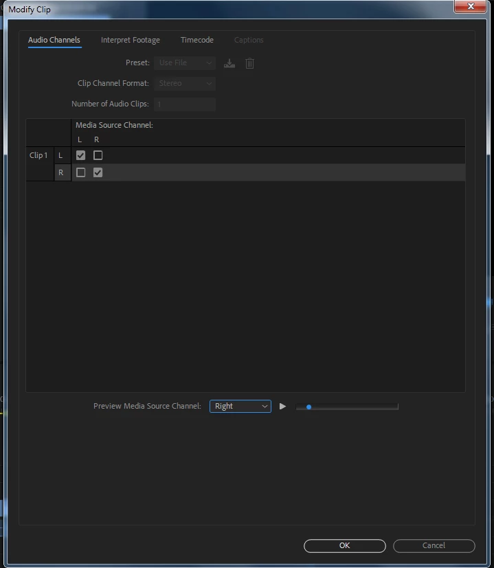

Make sure that the settings in the camera is set correctly. You don´t mention what camera, brand/model, you have or how the mic is connected, iow 3.5 mm or XLR. Many cameras have the option to take let´s say the left channel and duplicate it to the right channel or vice versa and that will get what you hear/see. The camera itself won´t identify the microphone as a stereo mic, so it is easy to forget that one changed this for some years ago. This must always be done manually. Consult the camera manual.
Start there. 🙂
ImagewerxAuthor
March 22, 2020
Thank you and sorry,it's a Panasonic Lumix G9.Connected via a stereo jack plug and I can't find an option in the camera's settings that changes it from mono to stereo or dual mono.
I've not seen this before.Is this bit set correctly?
