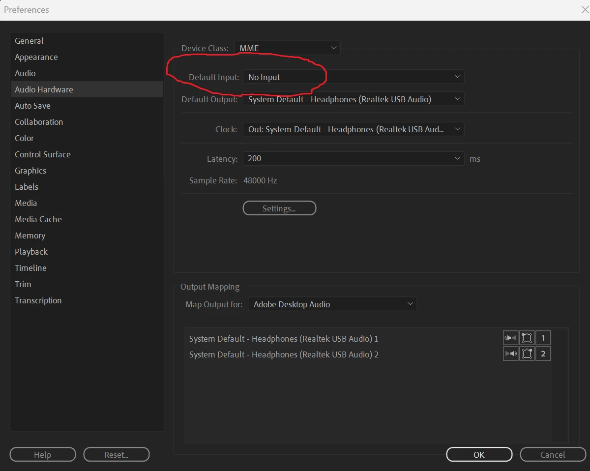

Not sure if this only affects the timeline playback (and not export) but have you made sure the Audio Hardware input is set to 'None' in the Audio Hardware settings . Edit/Prefs/Audio Hardware see screenshot.
This solved some stuttering issues I had a while back, but can't remember if it was only on timeline playback or export now.
Worth checking though
October 4, 2024
Thanks, I am getting quite desperate, so any tip is very welcome. Turned it off. Stuttering is still there. I tried another part of the scene: https://www.dropbox.com/s/4cgakm72rczylmb/Poetsen%20topshot%20hoog.mp4?dl=0
