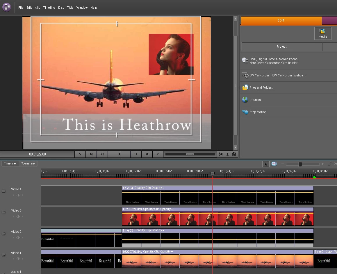

    Here's a look at how your Timeline would look:
    Think that image might be from PrE, but it will layout basically the same - just look a tad different.
