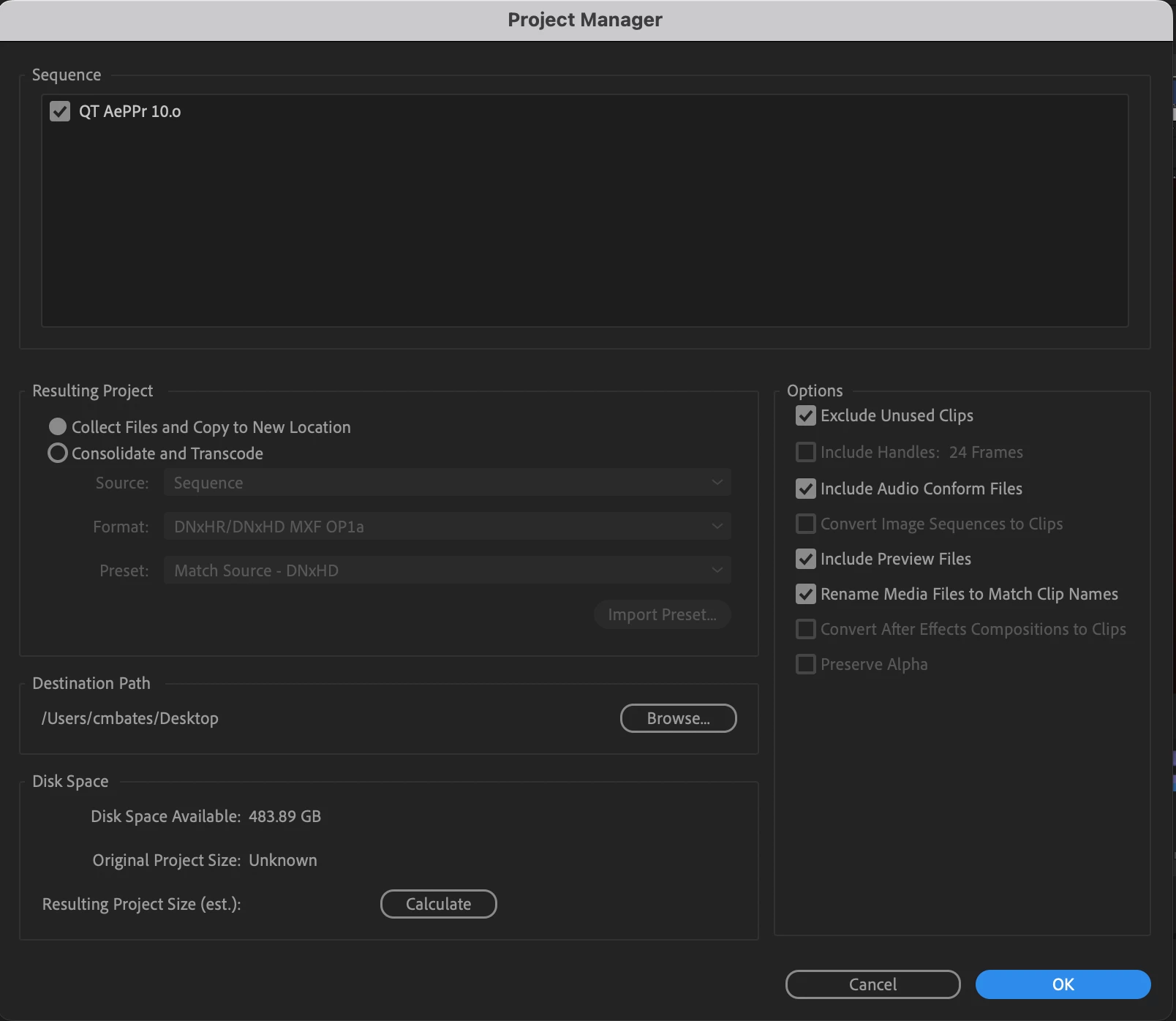

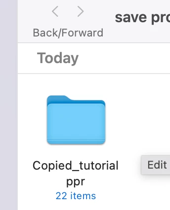

Jul 24, 2023 12:14 AM UTC
One thing for future. Go to file>project manager  and consider collecting and copying to new location. I recently discovered this and it has made life easier. It stores all assets and project in one location. The copied file can also be sent to someone as a complete folder  no more " media off line"
