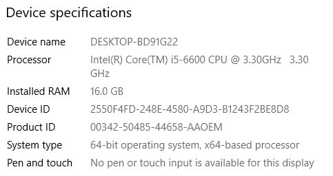

I've attached my PC specs below if this helps. I will have to keep syncing manually for now but would really appreciate any help with this issue.
