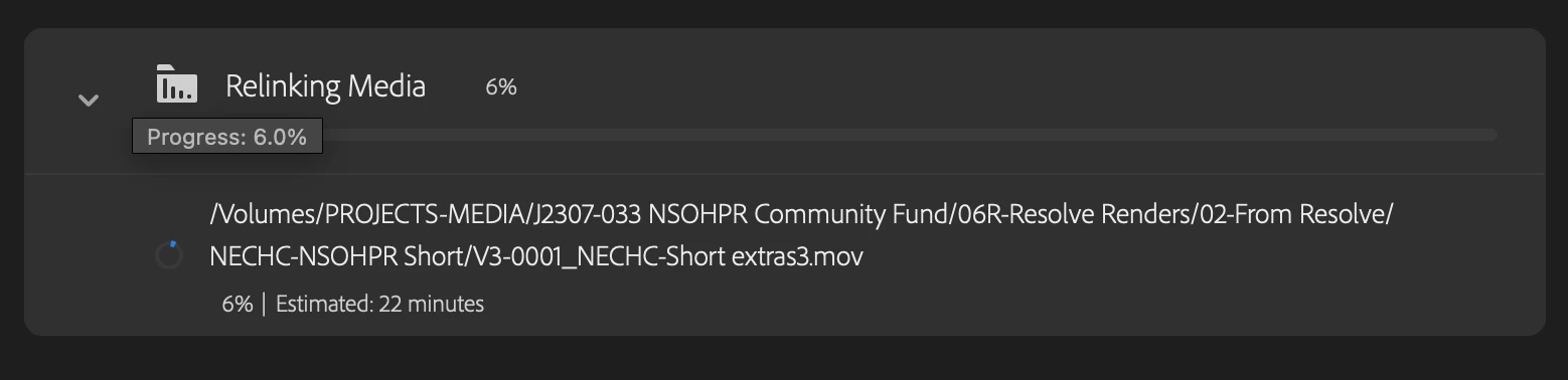

Not sure why this is the case, but relinking my media every time I open a project just seems to be taking so long.
MacPro 2019, 3.2ghz, 96gigs of RAM
Running media and shared projects off a Synology NAS.
My most recent project which involves a dozen short 2mins videos can take up to 21mins to fully relink my media every time I open the project. Why does it need to relink this stuff at all? It knows where it is, doesn't it?. What exactly is it doing and why does it take so long?
Is there some kind of setting I have set wrong that forces the app to relink everything again and again?
Am I doing something wrong?
Bruce Bullis
January 30, 2024
How is the Synology storage mounted on the OS?
How often does the IP address of your Synology change?
We'd be curious to take a look at your .prproj (don't need media).
