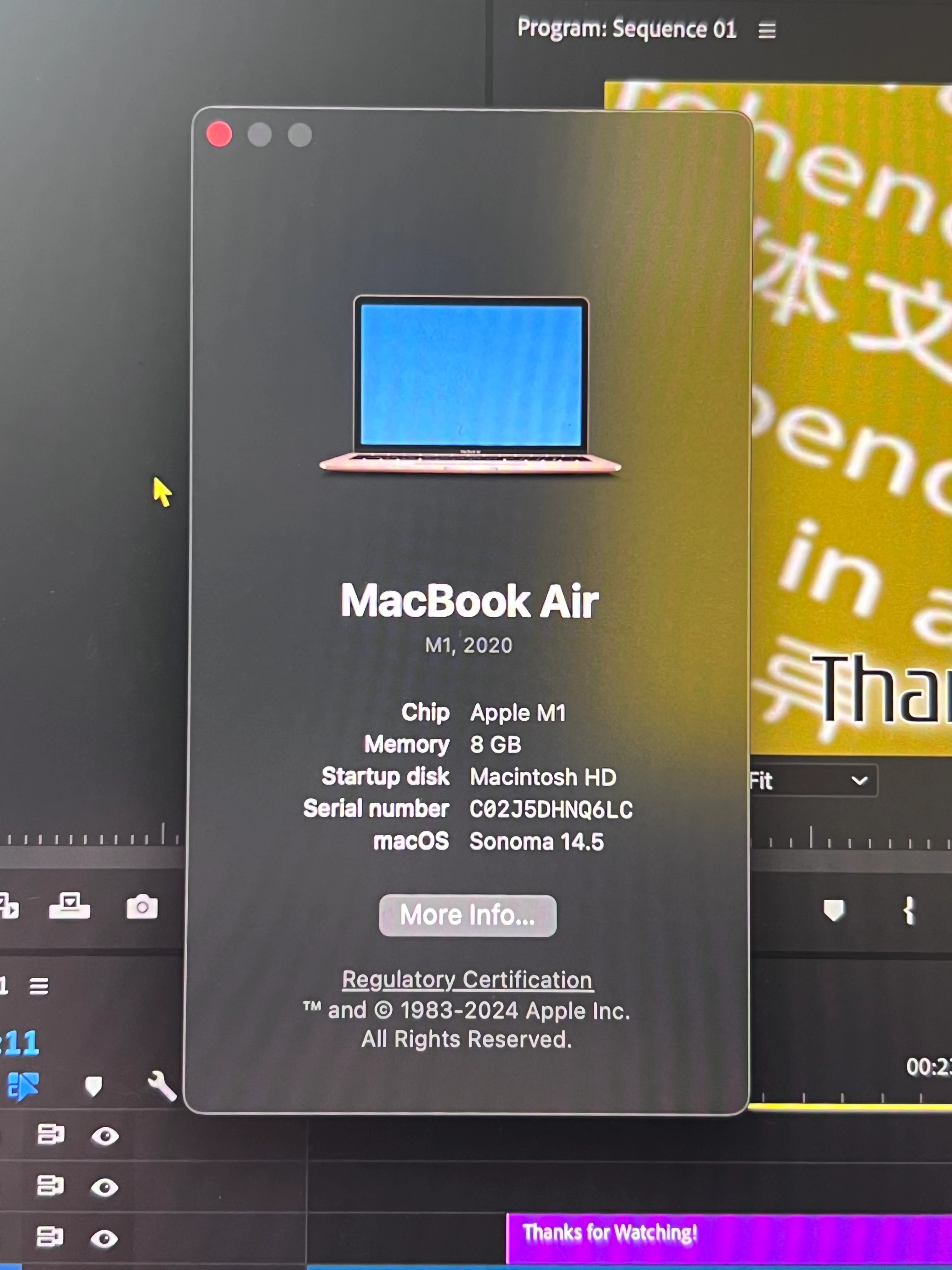

I'm not a very technical person, but here's all the info I got. Also, I took my 24min video and split it in half. My plan was to export a 11min and another 11min and then take those two videos into one sequence and export the full 24min, incase it was an issue with a corrupt file or something. The first 11min video exported without issue, the other half gave me the same "out of memory" also around the 70% completion part. My guess now is that maybe one of the clip files near the end is corrupt? My next option is to try and export the video on my brothers MacBook Pro. Anyways, here are the images.

Looking at your computer specs, you are at the very low end of Adobe's minimum requirements for Premiere Pro.
It sounds like you're running out of memory (not storage) during the export because your machine is not very powerful. However, looking at your export settings, there are a few things you can do to make it less taxing on your computer's memory.
One or all of these are recommended to speed up your export and require less memory from your computer:
1. In the Export window, set Audio Sample Rate to 44100 Hz. Your sequence has an audio sample rate of 44100 Hz, but you're exporting at 48000 Hz. This is adding no increased quality to your audio but will require more memory to export.
2. Change your sequence size to your export size. Your sequence size is 3840 x 2160, but you're exporting to 1920 x 1080. Setting your sequence size to 1920 x 1080 and then resizing your footage in the timeline (right-click your clip and choose Set to Scale) will reduce processing time.
3. Resize your footage and change your frame rate to CFR. Your footage was shot at 3840 x 2160 with a variable frame rate (VFR). It will significantly speed up your final export time if you resize this and change the frame rate to a constant frame rate (CFR) first. You could do this with Premiere Pro or software like Shutter Encoder Shutter Encoder. I recommend using a mezzanine codec like Pro Res 422 for this.
Hope this helps! Let me know if you have any other questions.
