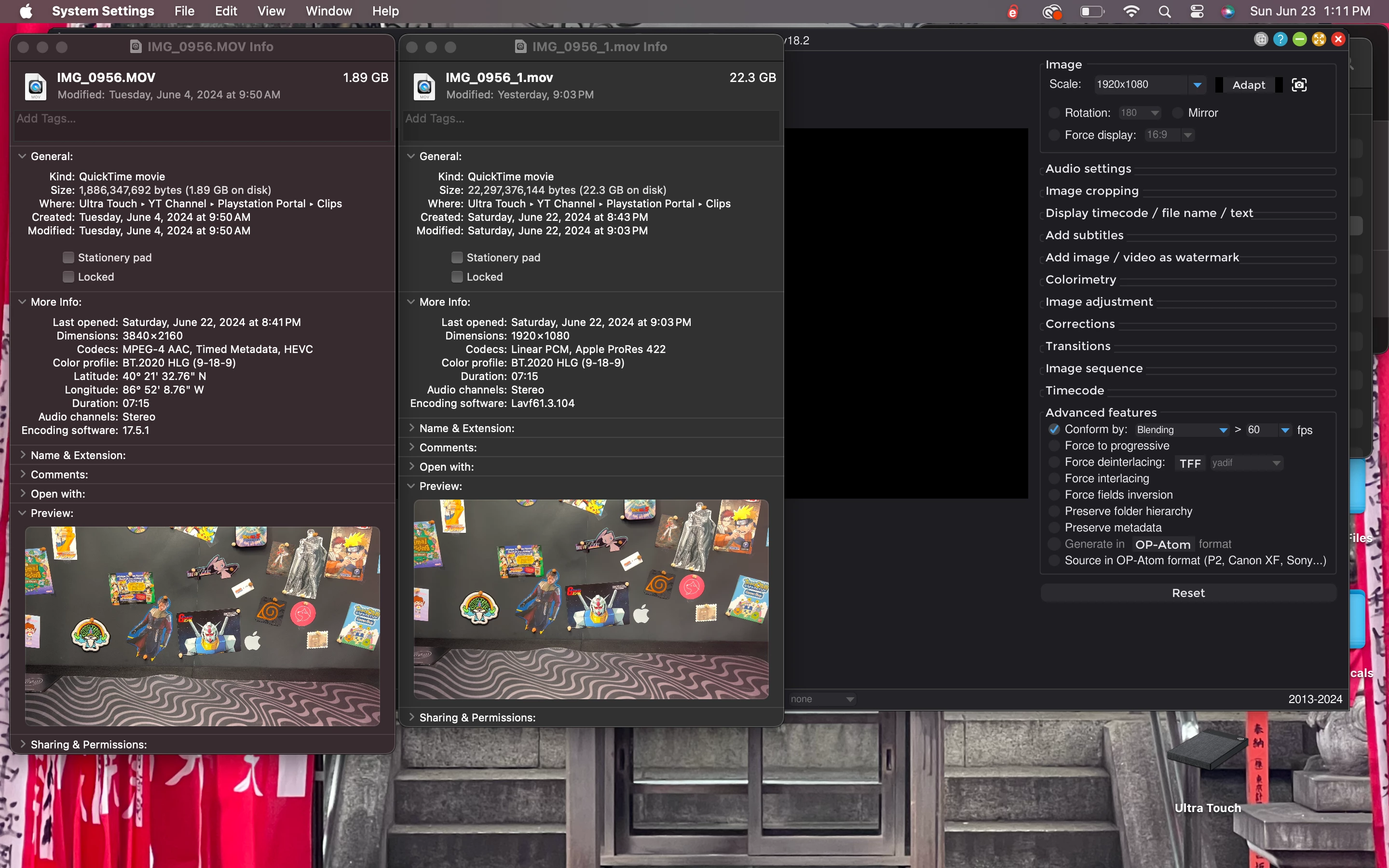

Sorry, just one more question. I'm experimenting with Shutter Encoder so that I know what to do with future videos. I take a video file, I go to "Choose Function", click "Apple ProRes" and "422", go to "Scale" and set it to "1920x1080", then go to "Advanced Features" and "Confirm by Blending" and set it to 60fps. I then press "Start Function" to start confirming my video clips. I took a 1.89GB file and followed those settings and got a 22.3GB file, so I actually got a bigger file instead of a smaller compressed file. Where did I go wrong in that process?
