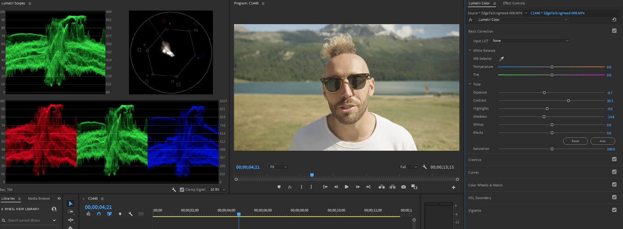

I just tried both LUTs with both clips. And had no troubles, but I think the reason you did is simply not fully realizing the true nature of LUTs.
They can do seemingly amazing things, but the colorists I know all call them the dumbest math out there. You have to be careful in testing them before using them as most LUTs actually can in the right (or perhaps, wrong) circumstances do amazing artifacting. So for some clips of a job they might work fine, but something with darker shadows or highlights or something is mangled.
And all LUTs are built for clips with specific color and tonal range values. Any clip "outside" those values gets clipped. So all the colorists I know teach applying LUTs after a node (Resolve) or 'layer' in an Adobe app, where you can trim the tonal ranges and saturation to fit within the LUT so it won't clip the whites, crush the blacks, or over-ramp color.
And ... in applying both these LUTs, for each clip, I found that applying them in the Creative tab and using the Basic tab controls to 'trim' the clips into the LUTs ... worked beautifully. No clipped data at all. In fact, as I brought the "exposure" slider down after dropping a LUT onto the guy clip, I could watch the clipped line of forehead area simply become the full data of a properly exposed image.
So ... it might be how you're applying the LUTs. Here's an image showing the Scopes and the Basic tab settings, with the SLog3->Rec.709 LUT applied in the Creative tab.

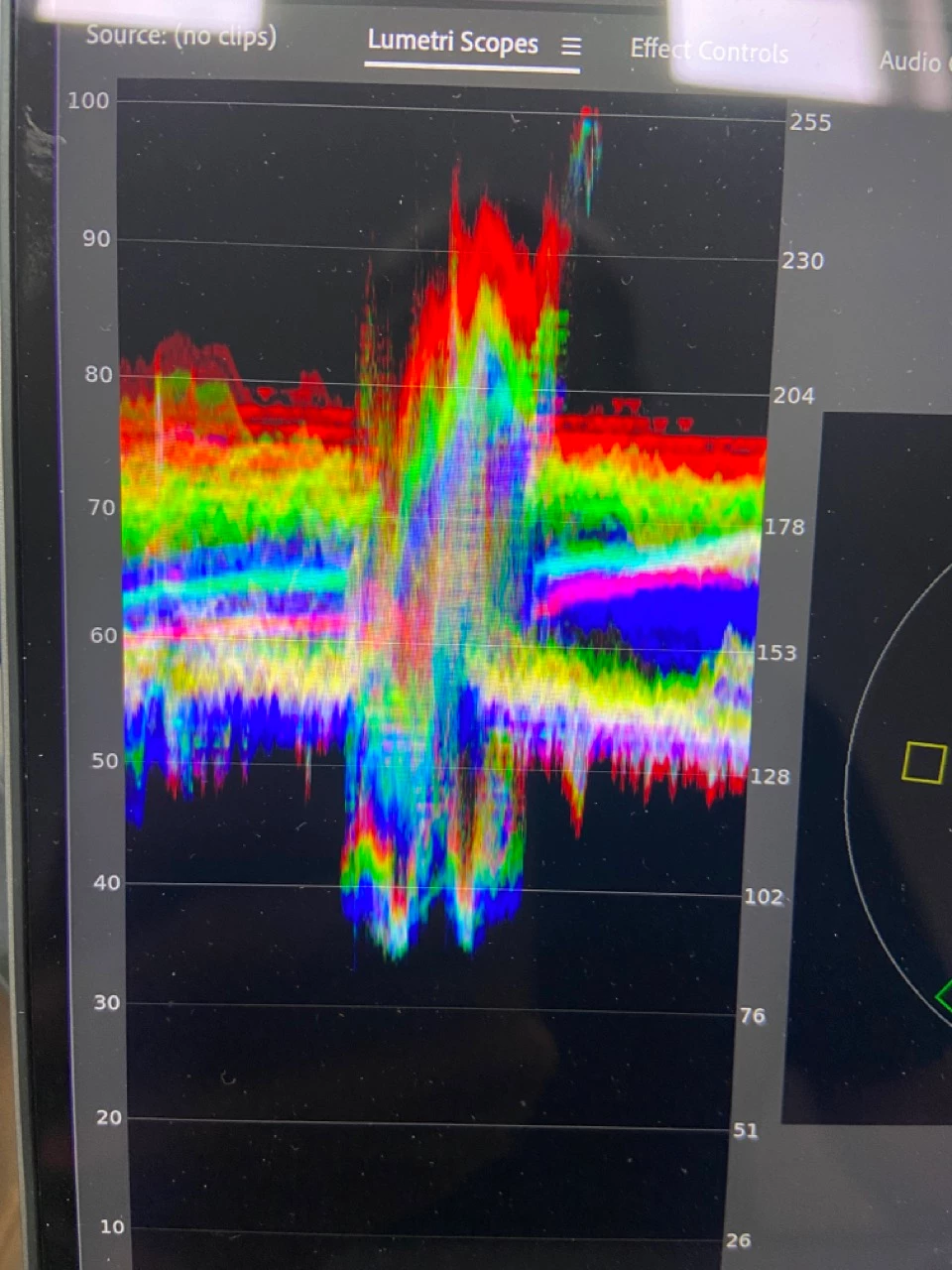

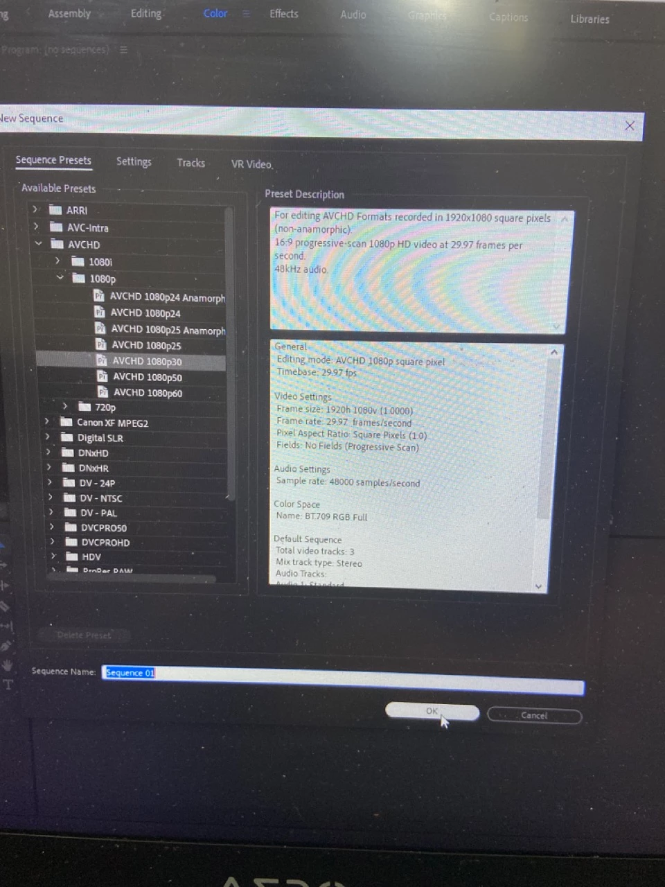

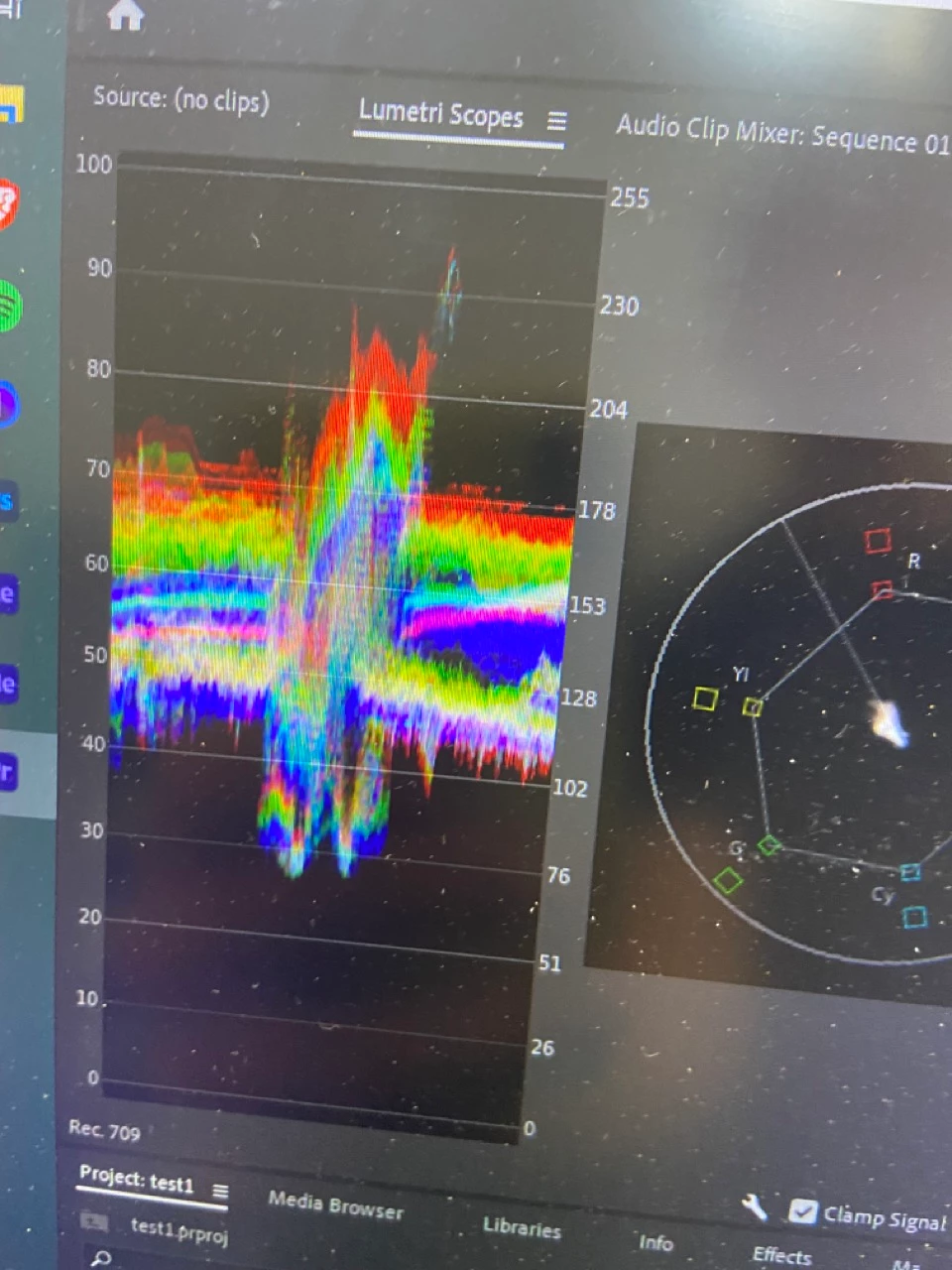

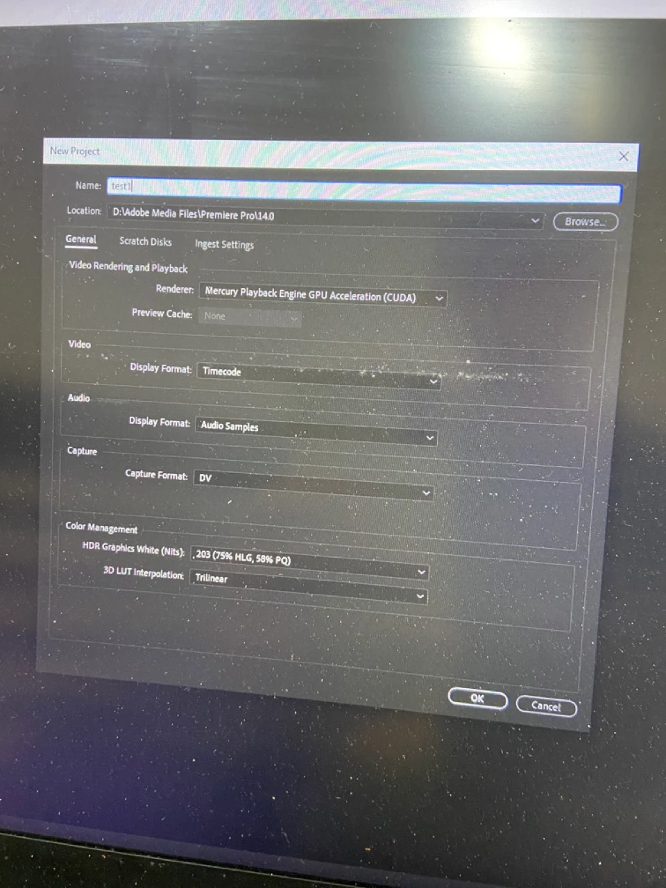

I guess I'm always rushing with these replies and not being very scientific with examples and explanations. This time I took the time to properly compare two clips on windows laptop and M1 Mac and I realised that the problem starts even before applying the LUT. I attach two waveforms of raw clips before adding the LUT. It's same timeline, same settings for sequence and the project, same file, same latest Premiere Pro 2022. And you can see that the waveform starts at different point on one computer than the other. Clearly there is a software issue there and it prevents me from working with my old project files on new Mac without reworking color correction from scratch.

Ahh, PC and Macs ... there's a fun issue there, in that the wonderful folks at Apple chose intentionally to "reinterpret" video standards differently than all others. Mac OS has it's ColorSync color management system, that does two rather nasty things to video media.
First, they only apply the first of two required transforms. The apply the camera (scene) referred transform, but not the also required display transform.
Second, they chose to apply an odd gamma of 1.96, when the Rec.709 standard clearly and directly calls for gamma 2.4, with 2.2 acceptable for "bright room" working environments.
In order to get around that as best as possible, the Pr engineers added the "display color management" option in the Preferences. All Mac users, and most PCs should have this checked. Unless you're running a pretty solid CM setup with stringent calibration/profiling to Rec.709, that should be selected.
So ... checking to make sure that the Mac has the "display color management" option selected, does that help at all?
