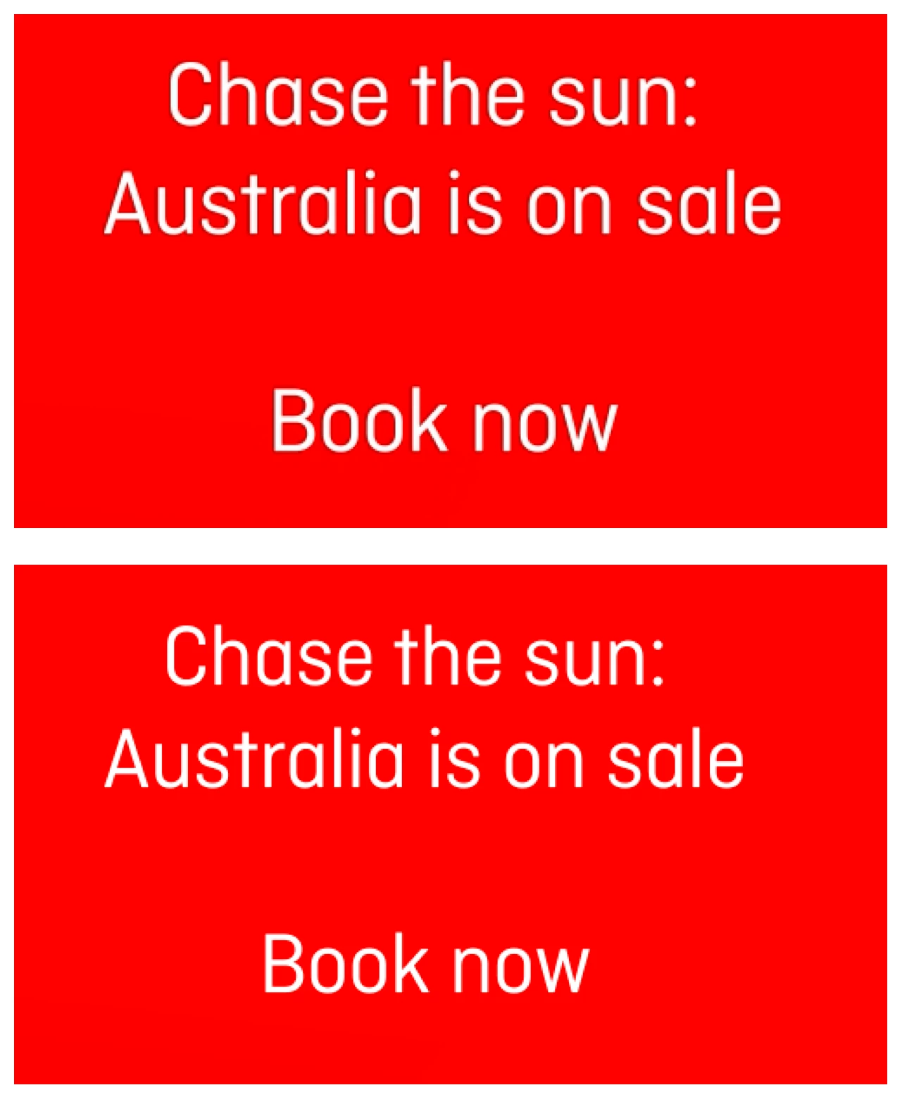

    It's 2017 and this is really happening and nothing to do with export setting or mismatch sequence settings etc. Top is rendered and bottom is unrendered. I'm a professional and have spent months tying everything to work this problem out. Please adobe everybody needs this fixed.
    Jeff Bellune
    July 14, 2017
    Check your default render codec (not your export codec).  You can find it under Sequence>Sequence Settings>Video Previews.  Odds are you'll find the problem there, whether in the codec choice, its configuration, the frame size or the available processing options.
