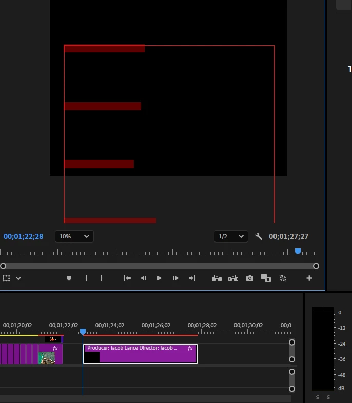

I was trying to make credits at the end of a video, but then the text suddenly dissapeared. I'm not sure exactly what happened, but I've run into the issue before and been able to get it to work by deleting and redoing the text. This time it won't work no matter how many times I try. Can someone help?
Here is how I ran into the issue:
I made some text on the screen with a large text box continuing off of the screen.
On the effect controls tab I made keyframes so it should start off the screen and then move up onto it.
After doing this, the text dissapeared. The text is still there, just invisible. This is what it looks like:
It would be great if someone could help!

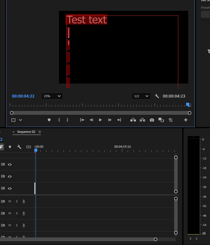

It is version 25.2.3. My operating system is Windows 11. I have also used it on another computer with the same issue that was either 11 or 10. In another sequence it is somewhat visible as shown here:
Do you have any ideas?
Thanks!
