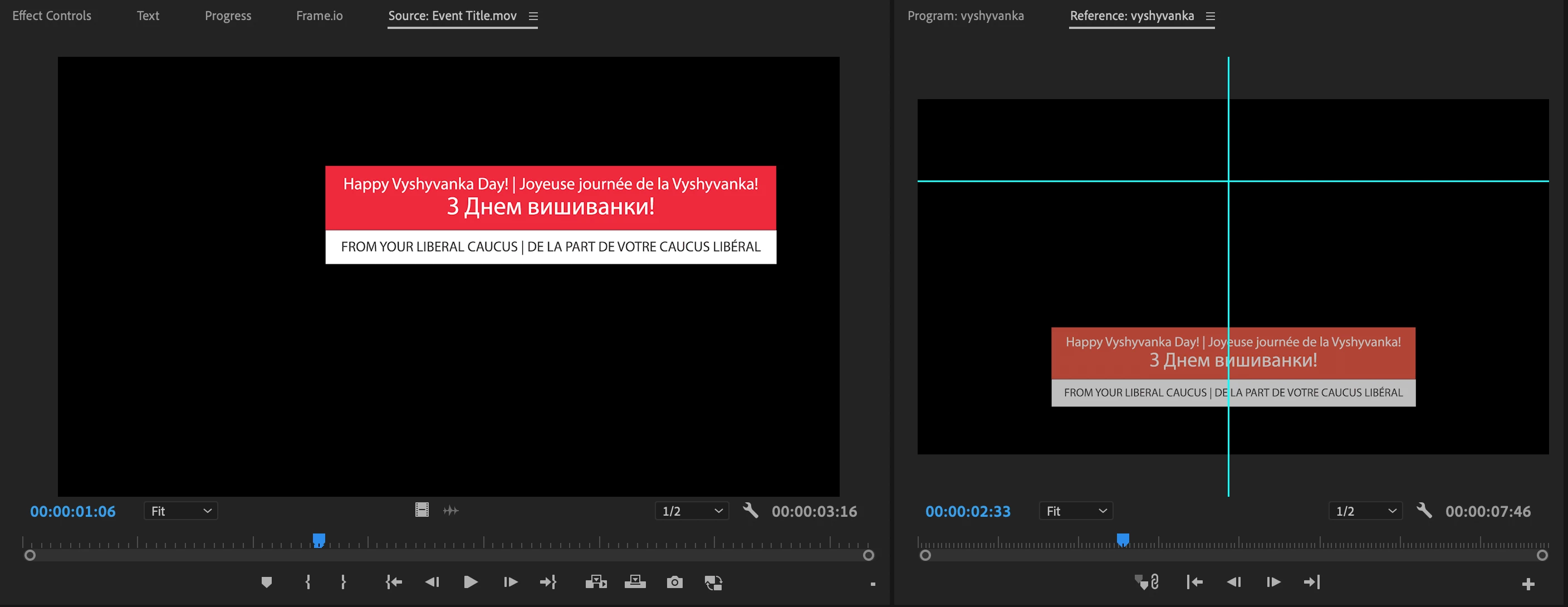

Hi guys,
As you can see in my screenshot, the colour changed as soon as I drag it to the timeline. It is an animation that I made in AE, and I don't understand what happened to the colour.
Thanks ahead for your help!

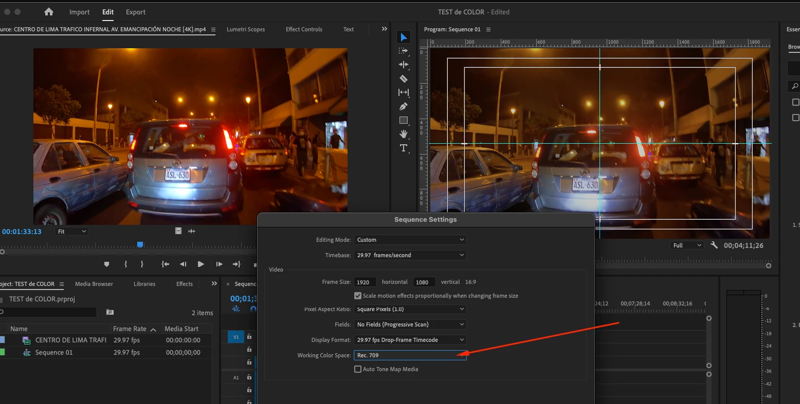

Otra opción más sencilla en la que podrías fallar en es sequence setting:
Como ves en la foto, cambie a propósito el rec 709 y automáticamente cambio de color.

Thank you for taking the time to report this. I have a couple of questions for you:
(1) Why are you viewing your graphic in the Reference Monitor? The Reference Monitor is not for playback and will not always be in sync with the Program Monitor. Does it look any different if you view it in the Program Mon?
(2) What sort of file is that After Effects Graphic? Is it a .mogrt (Motion Graphics Template) from Ae, a Dynamically Linked Ae comp or an exported media file from Ae?

Hola, eso normalmente sucede si tu perfil de color está  en un modo diferente del REC 709
Espero sea solamente eso.
