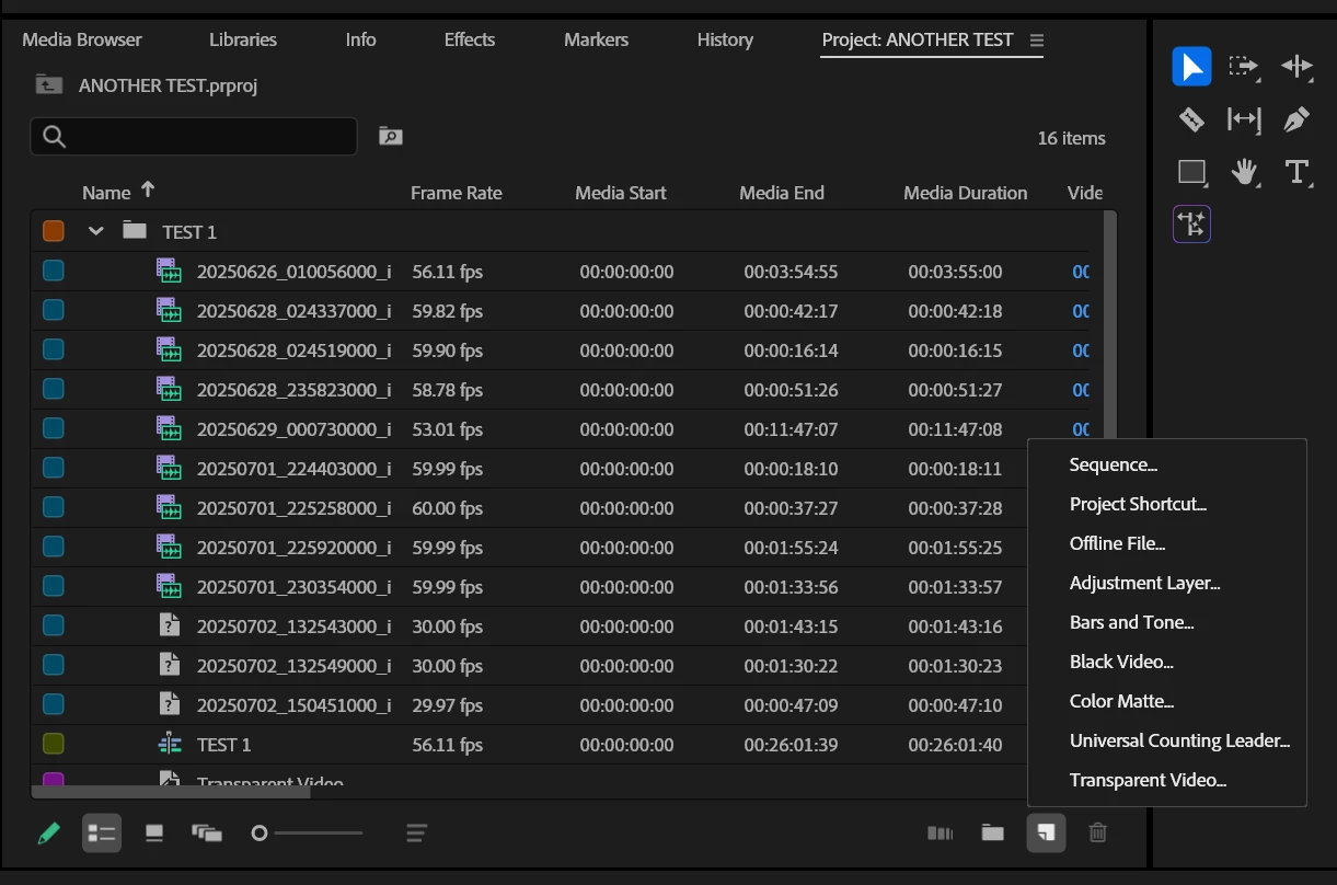

FlyingFourFun
Jul 6, 2025 10:11 PM UTC
Another work-around option is is to create a separate video track, and use a transparent video and add the bur-in effect.  When you go to make your final export,  just turn off the whole video track that is reserved for the timecode Burn-in.
