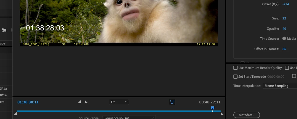

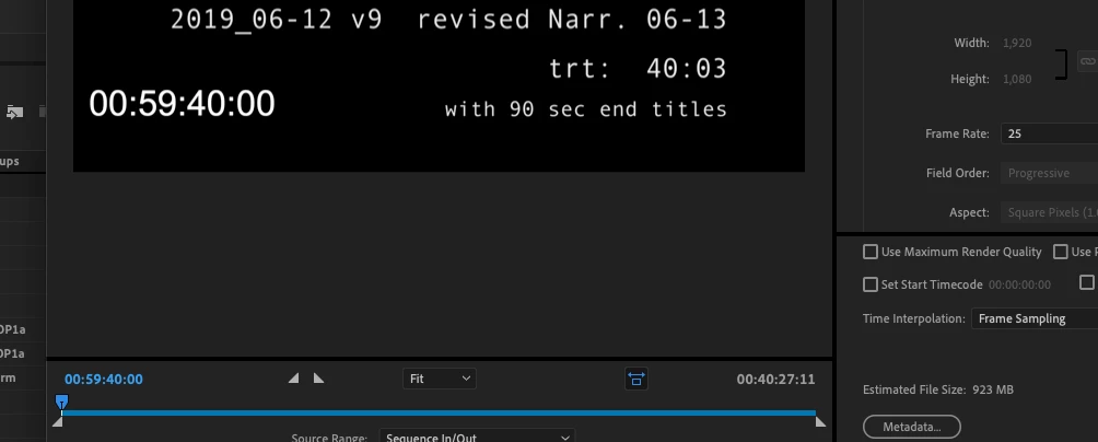

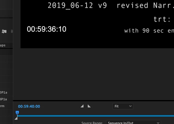

Premiere Pro 13.1.2 (build 9), and Media Encoder 13.1 (Build 173). I'm hoping my frame grabs will upload to show that outputting a sequence (1920x1080, 24 fps, ProRes 422 HQ media) to Media Encoder (by selecting Queue), adding a Timecode display effect, the timecode displayed is WRONG.
1) The sequence starts at 00:59:40.00. This frame shows the burnin at 00:59:36.10. 2) Adding a frame offset of 86 frames to start the sequence at 00:59:40.00, the last frame of picture the timecode is way off (54 frames). 3) Changing the timeline frame rate to 25 (and no 86 frame adjustment), the start timecodes match. 4) The last frame of picture the timecode is 1 frame off from the burnin (the burnin is wrong).
Timecode doesn't work correctly as an adjustment layer, displaying incorrect timecode for the sequence AND the clip, and Media Encoder doesn't at all display the correct timecode.
