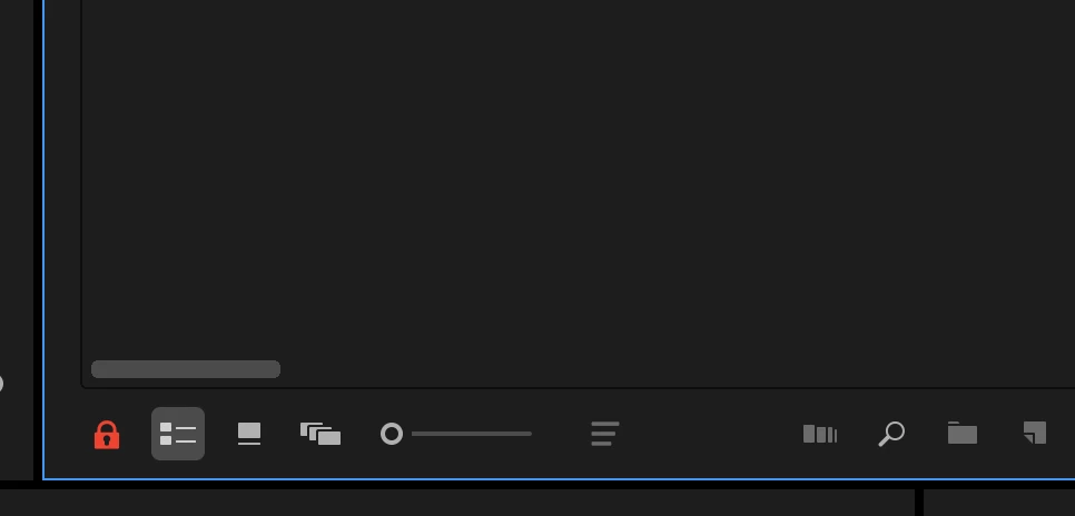

Some things to double-check:
Did you accidentally set the project to read only?
Does Premiere Pro have full disk access?
