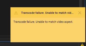

I'm trying to render and replace a dynamic linked clip, but I keep getting this error message: "Transcode Failure: Unable to Match Video Aspect". I've tried every kind of video format to encode with and they all come up with the same error message. My timeline is 1080x1350 (for Instagram). Would love for this to be fixed, I know I can export through After effects and click replace clip, but then I lose the option of switching it back to the Dynamic Linked version. Even then, this should be working inside of Premiere anyway. Thank you! 

I appreciate the help, but the render and replace tool doesn't give me the option to choose a standard frame size. Even then, why are so many solutions just workarounds? Why can't this just be fixed?

How is this possible.  I see this all over the site. It is just nuts that you can't use a video editor to edit video.
I imported 1 clip, then I cut it up into segments and tried to save the project cuts as individual clips.  This error is preventing it, all presets fail.  It is supposed to transcode it?  how can any framesize be holding it back?  You know handbrake is free, I am sure you could use that instead of whatever it is that makes premiere break doing the most simple tasks on the planet.  This is incredibly frustrating.  Maybe one day you will build it for the users, and not for the tinkerer that wants to constantly work around simple bugs to do simple things.
very frustrated @32 dollars a month for years...and users still the last on the list
