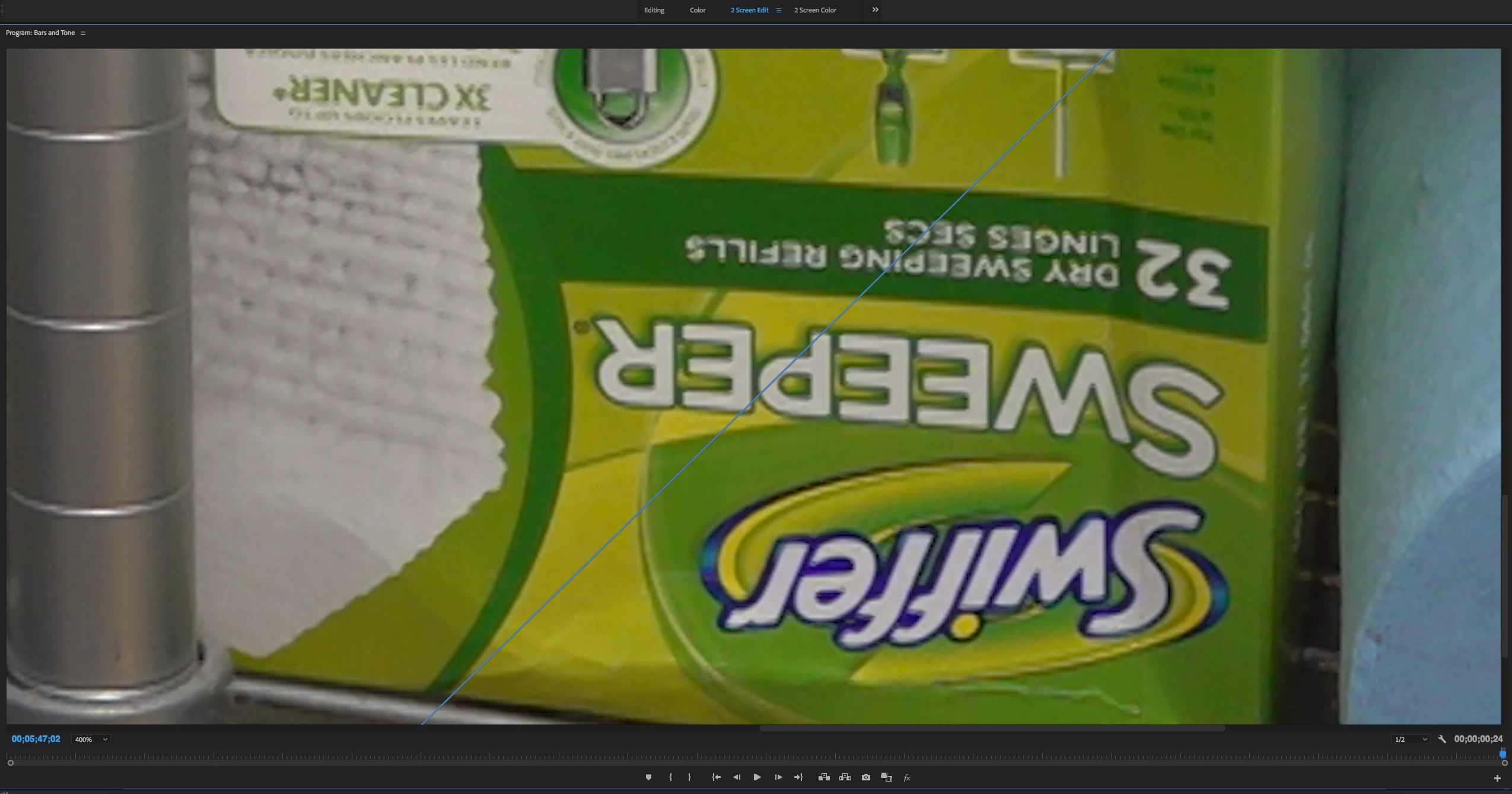

I just did a test from some Sony MXF footage to ProRes 422, and can't see any difference at 400% (the Pro Res is on the left, the original on the right:
MtD
July 24, 2018
And here it is transcoded to CineForm (CineForm on the left, original on the right):
MtD
