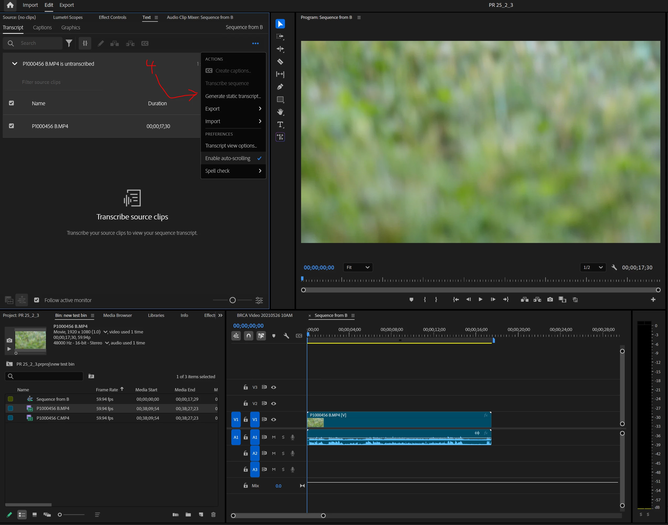

> change the workspace to captions.

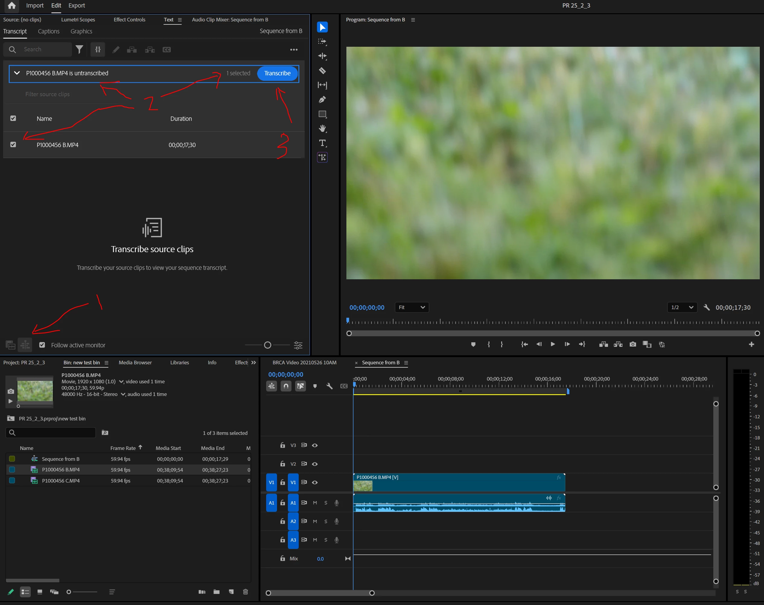

Are you saying that you are in a Workspace such as "Editing" and you switch to the Workspace "Captions and Graphics"? This is not necessary; if you are in sequence view (#1 in the first screenshot below), the 3-dot menu will have the option “Generate Static Transcript” (#4 in the second screenshot). If you already have a static sequence transcript, then you will see "Generate text-based editing transcript" and "Re-transcribe sequence."
If you don't see that, post a screenshot.
> using the sequence from the timeline and clicked "Transcribe" It did transcribe. It's just confusing because the window says "Source Clip" Maybe that doesn't refer to the source clips in the project bin? It also shows the original clip name for the transcription and not the sequence name on the timeline.
What you describe is that it is creating a source media transcription. See the first screenshot below. 1 - we are in sequence/program monitor view. 2 - we have one untranscribed source clip, and it is selected for transcription. 3 - that Transcribe button will initiate the source transcription.
IF that is the only clip in the sequence, or if you transcribe all the source clips in the sequence, the text result will be the same as the static transcript. But that transcript would be text-based editing, not static, and would change as you edit the video.
