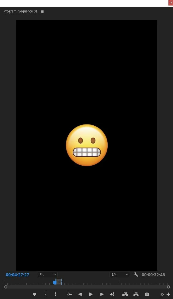

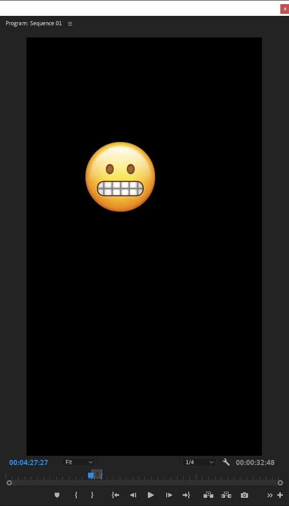

Its incredible - this issue hasnt been fixed for 4 years. Nesting is a disturbing work around that harms the workflow. Adobe please fix a basic effect that hasnt been working for 4 years...
Picture 1 and two demomstrates the position of the emoji where the only difference is a shutter angle on 50 on picture 2, which for some annoying reason completely misplaces the emoji to some random place instead of the center
