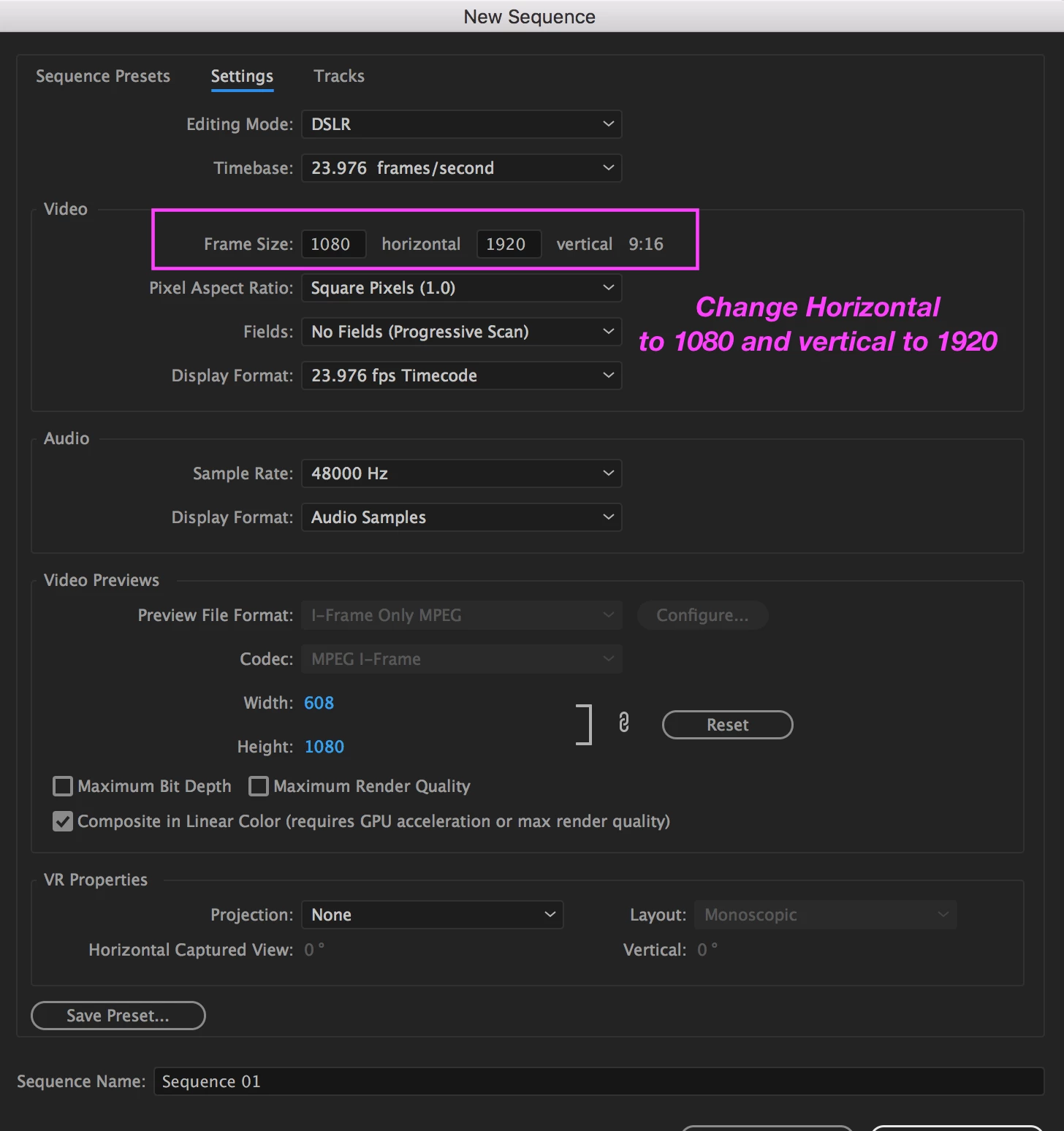

    1. First create a new sequence with custom dimensions of 1080 horizontal x 1920 vertical. After you create a new sequence, select, a 1080p preset, such as DSLR 1080p 24 fps, then hit the settings tab, here change the dimensions to be portrait. See screenshot, then hit okay.

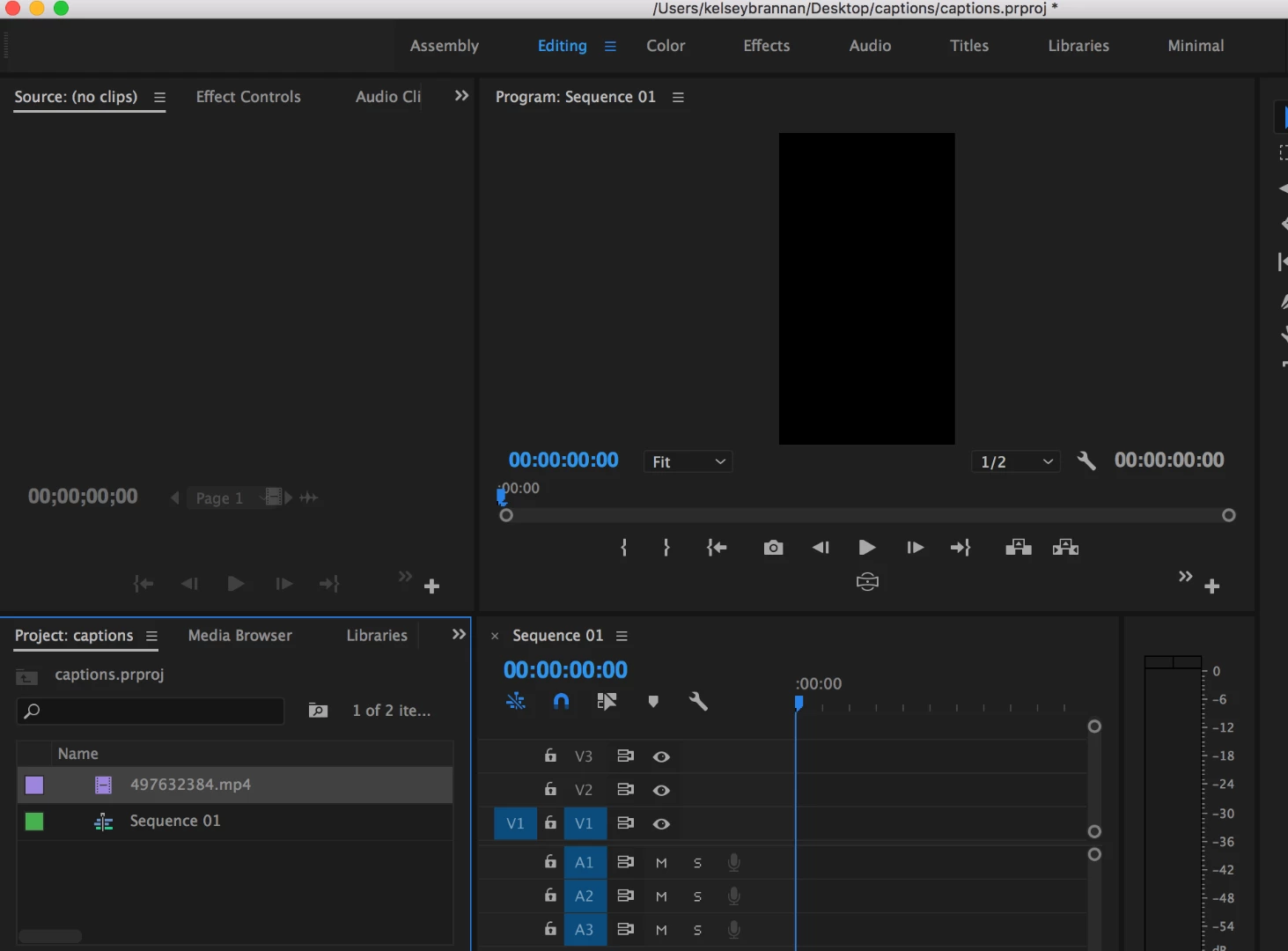

    2. You will now see that your sequence is in portrait mode.

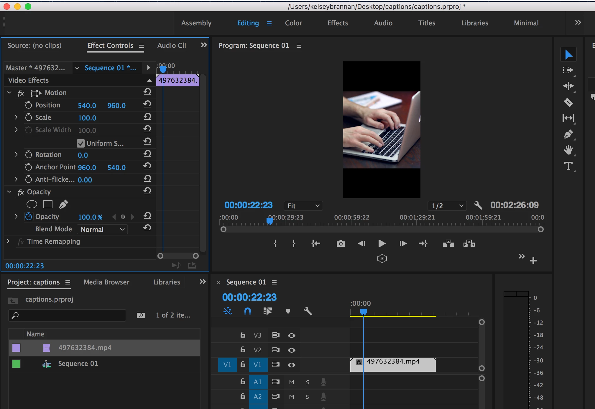

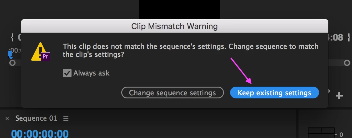

    3. Drag your video into the sequence, be sure to click on "Keep existing settings" when prompted.

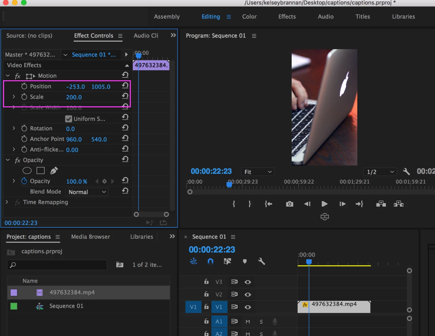

    4.  You then will see your video you need to adjust the position and scale of the video under Effects controls to reposition the video to fill the frame.

    Just set the framesize to 1080x 1920 instead of 1920x1080 in the sequence setting.

    but when i export the video on the left and right is filled with black

    You need to scale your footage in 1080 x 1920 sequence to get rid of those black bars.
