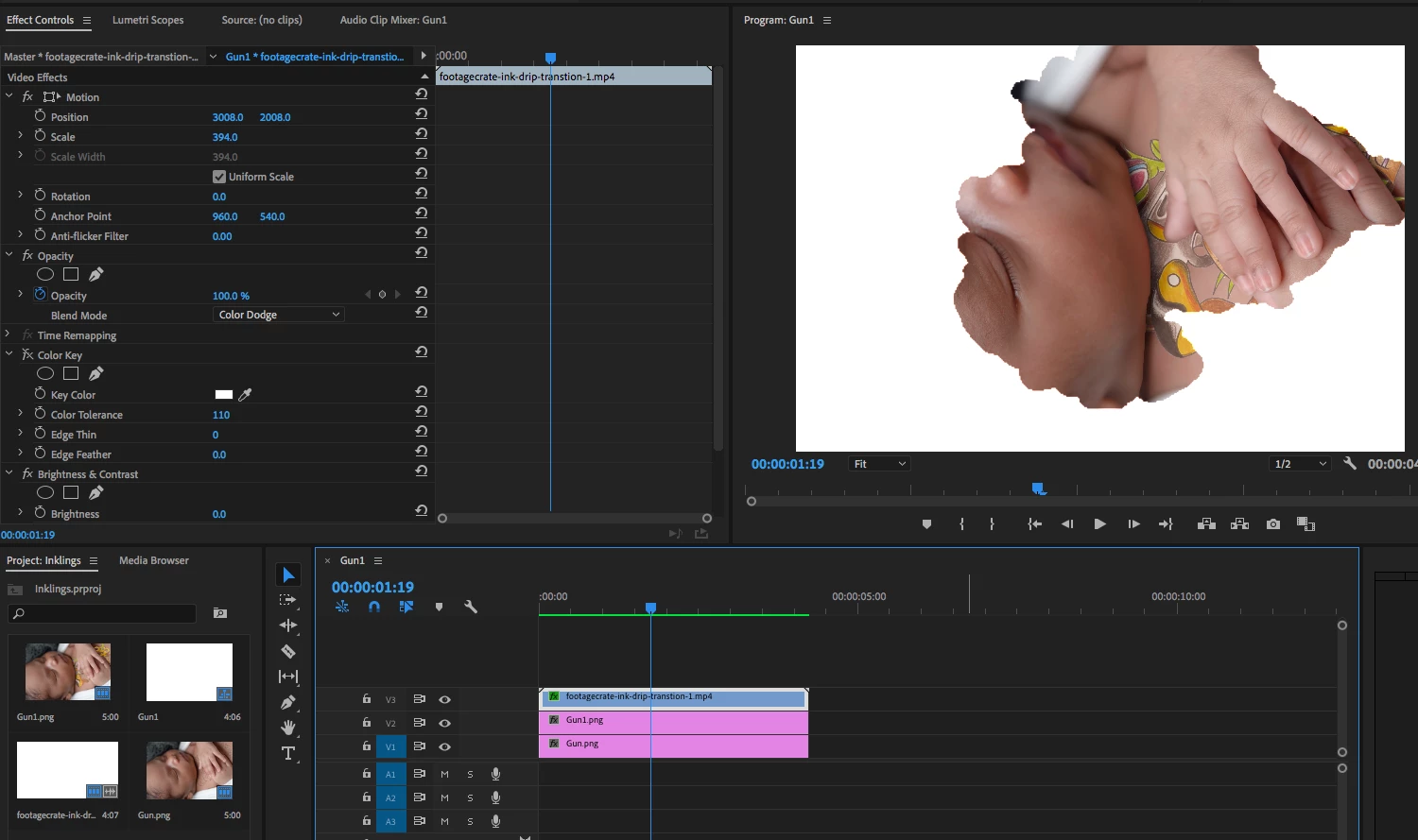

Just a little progress update. I changed the blend mode of the pouring ink clip to colour dodge, and this caused the coloured version of the underlying image to appear within the ink, on a white background. The image "pours" onto the white background as it should. However, I am unable to make the white background transparent in order to show the outlined version at the bottom of the "stack" of clips. I tried adding a colour key effect to both the pouring ink clip and the topmost of the two images to see if this would reveal the image below, but it did not. The background just stayed white.

Here's a frame from the ink overlay. It's an opaque white background, and the ink (which animates in from the top of the frame and spreads to fill the whole frame) is black. There is no alpha as far as I can tell.
Here's what I've got so far. As you can see, the "coloured" image bleeds in as per the ink overlay, but the white background does not show the "outline" image behind it, despite adding a colour key effect with white as the key colour.
