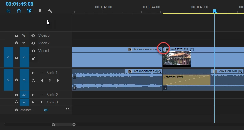

I have 3 clips on my timeline. 1 is 15 seconds long, 2 and 3 are 1 min long
I placed my default Cross Dissolve transition between the first and second clips and it straddled the two clips, as expected.
I tried to do the same between the second and third clips but the transition would not straddle the clips, the effect was applied the beginning of the third clip and when I went to the Effect Controls panel and tried to slide the clip to the left it got cross-hatched when it entered into the end of the second clip.
Can someone tell me why this is happening?

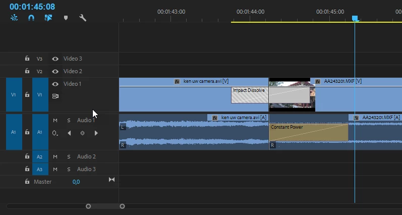

Longer version of Jim's answer:
The lines are an indication that there are not enough extra frames on the end of the clip to create the transition.
Ann Bens
April 5, 2018
It means the clip on the opposite side of the cross hatched side is not trimmed back.
If you remove the transition you see why.

OH! I see.  If I CUT a clip there is nothing left to transition into.  Sounds like I should work from In and Out settings, so there will be enough for transitioning.
Thanks
Using Win 11
Ann Bens
April 6, 2018
If you want transitions you always have to trim first.
