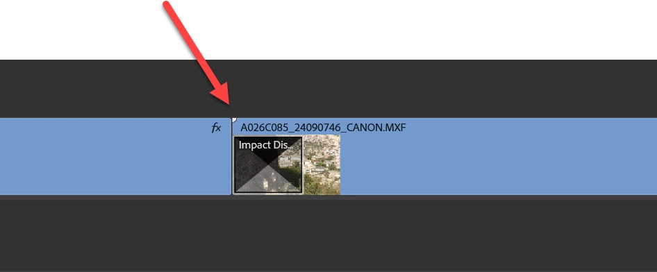

A transition will set itself centre at cut if both clips have sufficient handles.
If the transition is set Start to Cut it means the clip has no handles indicated by the white triangle
Applying transitions in Premiere Pro - handles

Hi Ann. My clips do show a handle/triangle just like your screenshot.
I have three clips, I put a crossfade between 1 and 2, it defaults to Start at Cut, I change it to Center at cut. CTRL + C, then CTRL + V between clips 2 and 3. Bang it pastes in as Start at cut.
What am I missing.

The triangle means that is the end frame of the clip ... therefore, you have no 'handles' to be used for the transition.
Most actual transitions need at least enough frames of 'cut' clip to match the time in the transition. So if you have cut one second off the front of a clip, and one second off the preceeding clip, your transition could be up to a second. Because of having "handles".
