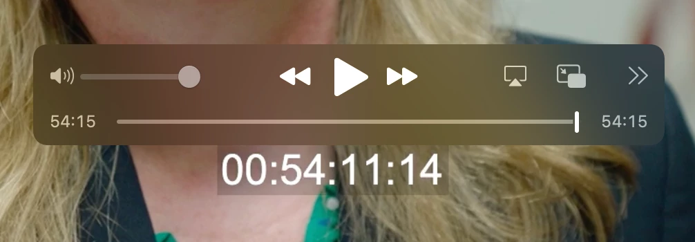

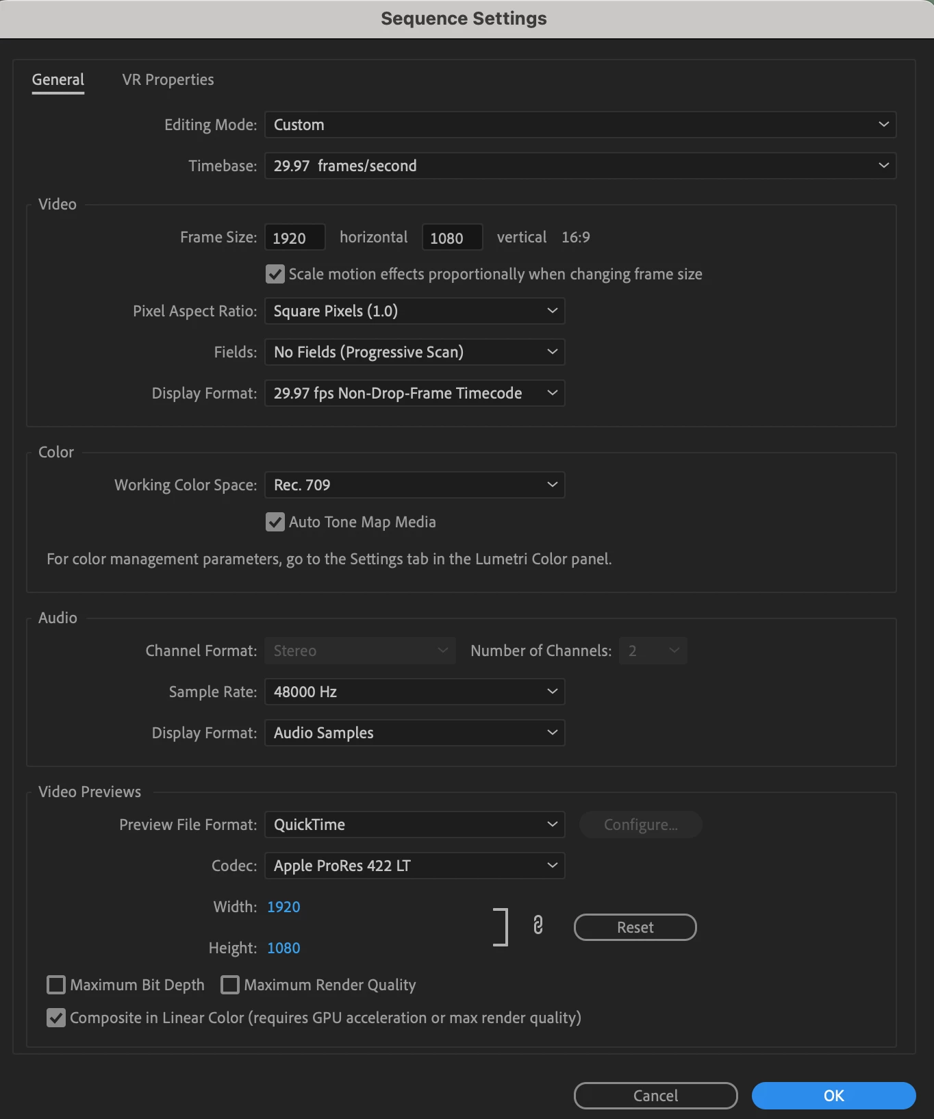

I'm running into a weird export issue that has me stumped. I'm working with 29.97 progressive scan footage, my timeline has a timebase of 29.97 and a display format of 29.97 non-drop frame TC. The issue is that when I export I get a QT file that is roughly 4 seconds longer than the timeline. Sequence settings are below:

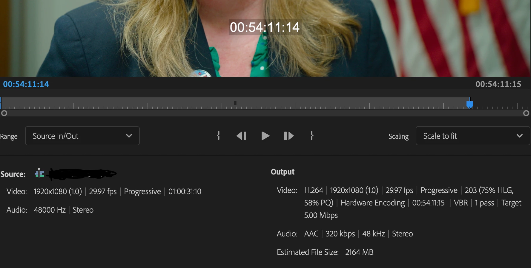

Export settings are:
 Everything looks kosher to me, but when I export I get a QT file that looks like this at the final frame:

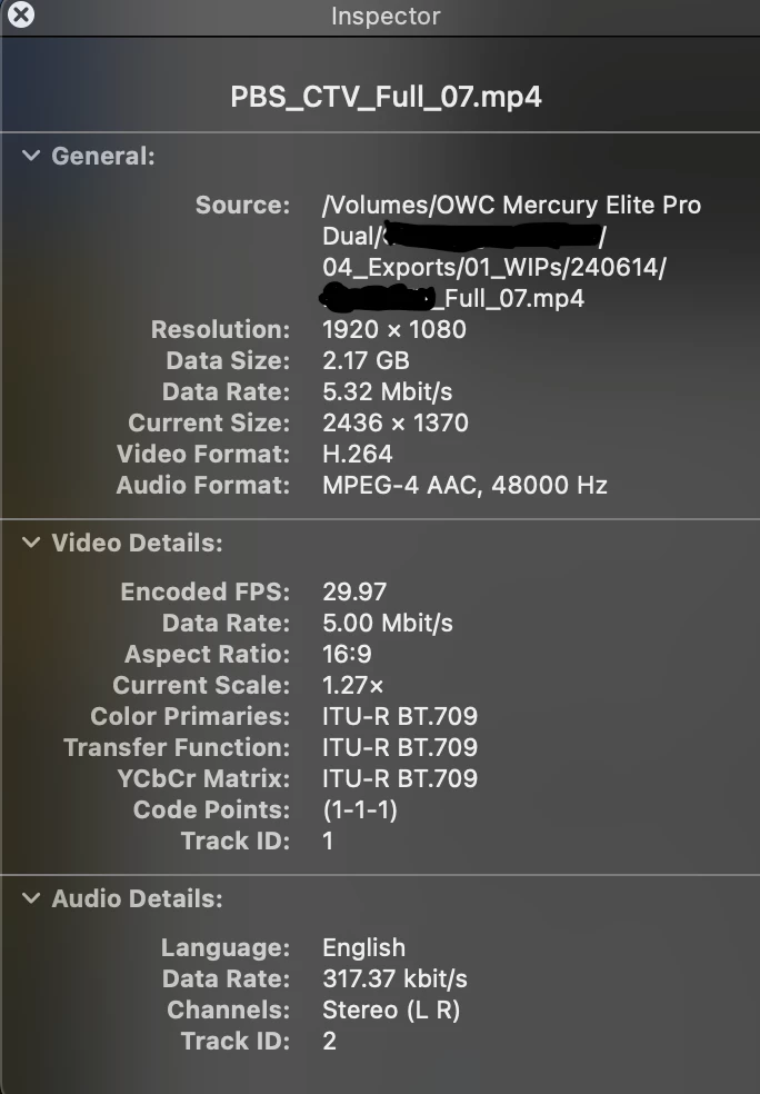

 Here's the inspector info:
Any ideas for what is causing this drift? I feel like it's gotta be a frame rate issue, but I'm just not seeing what the problem is.

It appears that Quicktime is interpreting the timecode format as Drop-Frame instead of Non-Drop-Frame, and this is causing it to count the frames incorrectly. I ran a test on VLC, and it is doing the same thing.
However, when I imported the file back into Premiere, the timecode was correct. You can verify this in the file metadata. In the Metadata panel, under the File heading, go to Start Timecode > Time Format, and you should see that it is Non-Drop-Frame.
So, it might be an issue with Quicktime Player and VLC, or perhaps the file is missing some metadata that tells these apps to distinguish between Drop and Non-Drop formats.
