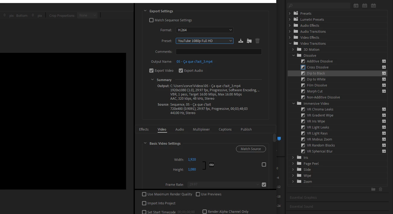

Sorry if this has been posted before, I've been searching for an answer and messing with it all day, im at the end of my rope. The files I'm importing are 1920x1080, when ive put everything together and go to export, the summary says the source material is 720x480. Ive tried different output settings from 1920x1080 to matching at 720x480 to making the it worse and it all looks like hot garbage.

It sounds like you edited your 1080 footage in a sequence set to 480. Please post a screen shot of your export settings summary like this example below:

This is what Im working on
Meg The DogCorrect answer
April 9, 2020
Yes, your sequence is set to Standard Definition 720x480, so you have been down converting all your clips to the lower resolution during your edit. Is this your intention?
