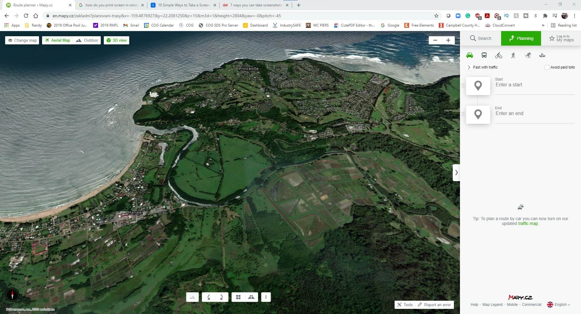

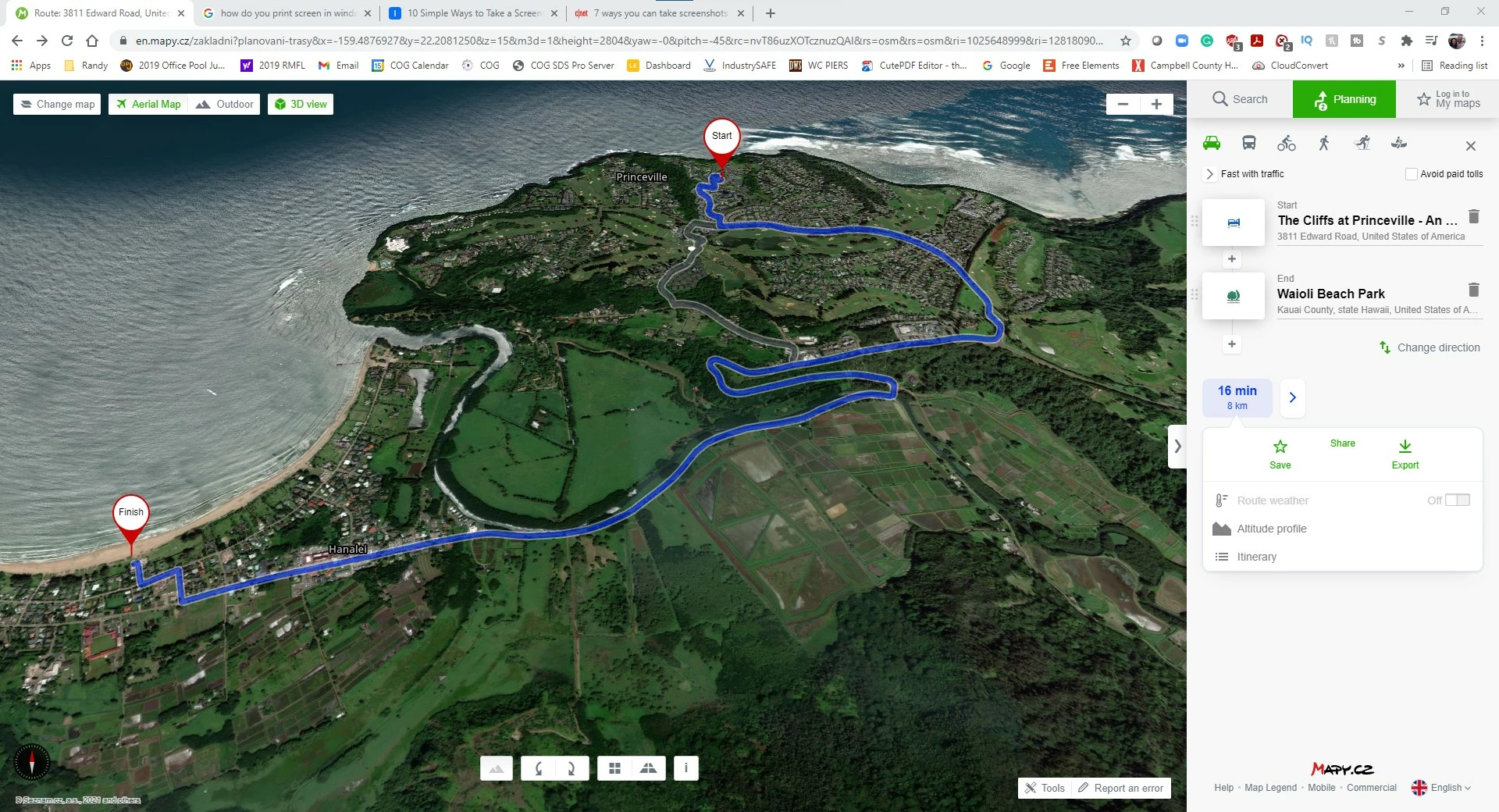

Okay, I have searched for this topic in the PP Community and extensively on YouTube and I couldn't find exactly what I am looking for.  What I am trying to do is trace a map route in PP using masks but I keep running into weird things.  I have included the two files I am using.  I am creating a huge family trip to Kauai, Hawaii and I need to perfect this trick because in 10 days on the island we did many, many activities.  The first clip shows the map without the route and the second clip has the path we drove by car.  On my timeline, I have the route clip stacked on top of the clip with no path.  I've tried using all three masks under opacity in the effects panel (eclipse, polygon, and the pen tool) and all of them give me ghost images and I cannot get it to follow the path.  It starts off doing really well but then the mask jumps and we are way off-road.  What I have been doing is starting at the Start pin, moving forward a few frames, dragging the mask, so on and so forth throughout the whole map.  None of my attempts have provided me the clips that I am wanting.  I have also used the map without the route in PS and drew the line on a new layer.  Then imported the PSD file into PP and tried using a mask reveal as well under opacity.  It still hasn't produced anything looking very professional.  I do not want to do this technique in AE because my knowledge of using AE is limited to a medium user at best.  I would like to do this all in PP.  I have even entertained the idea of dropping the $29 in Envato Elements to purchase the Map Route Generator for Premiere Pro.  But I KNOW there has to be an easier way to do this in PP.  I mean someone created this for Envato so I know it can be done.

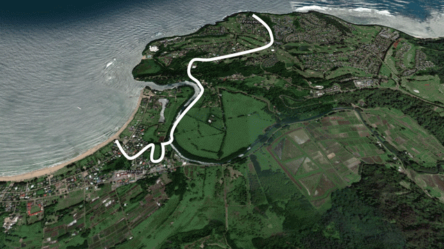

Taking a look at the two images you posted at first, are you looking for something like this?

Hi Randy,
I tried out your issue and was able to make a rough animated map in just a few minutes in After Effects that anyone at the advanced beginner level could handle using a Shape Layer (no fill, stroke to taste) and the trim paths command.
See a wonderful set of tutorials by Boone describing the how to here.
Here's the main one I'd suggest you check out:
Hope it helps.
This is the rough animation using 2 shape layers w/ 2 keyframes on one of the shapes.
Kevin
