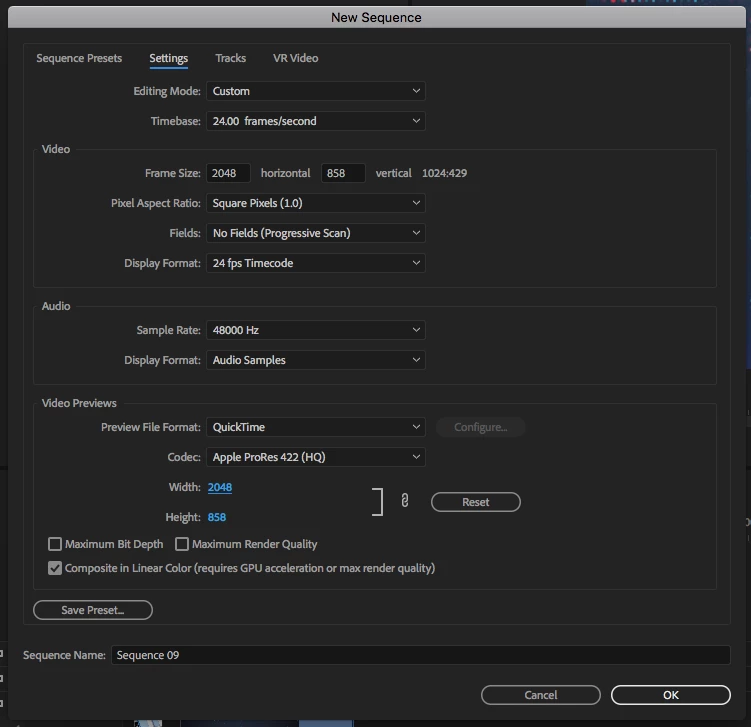

Sounds like we are missing a key to this workflow. Can we see a screenshot of your Timeline, perhaps, John?
Kevin

Anyway, Im away form the project at the moment but my I will attach a screenshot of my sequence settings along with the info below...
PP version: 12.1.2
Footage: 3200x1800 ProRes 4444XQ shot on the Alexa Mini
Thanks again for all your help.
