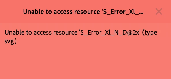

Hi everyone,
I'm using iMac Pro. When I using Premiere Pro, sometimes it will show that error, I don't know what is it, anyone can help!

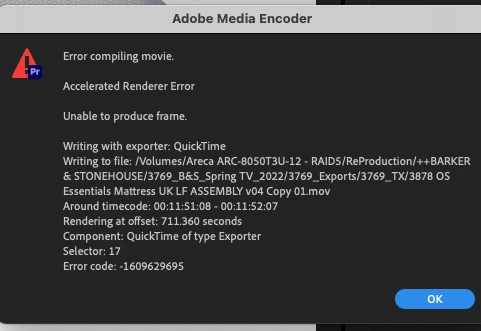

Not sure if it's related but I've also been experiencing an export issue with similar clips, where the sequence part exports and then throws up the attached message.  my only workaround is to export and reimport a TGA sequence and wav... then combine them for a second export... rather lengthy!
Thanks again.

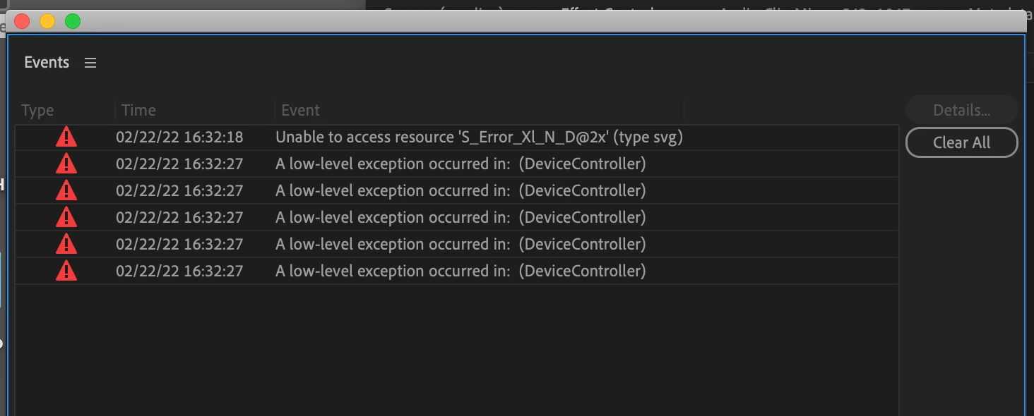

I've noticed if I keep saving the project under a different name, opening it up and work at it again the system it will take a few mintures for scrubbing footage to trigger the error.  I then imported into the same project media from an external recorder, ProRes LT, no problems at all in the same project.
Attached are some other erros the system started reporting.
