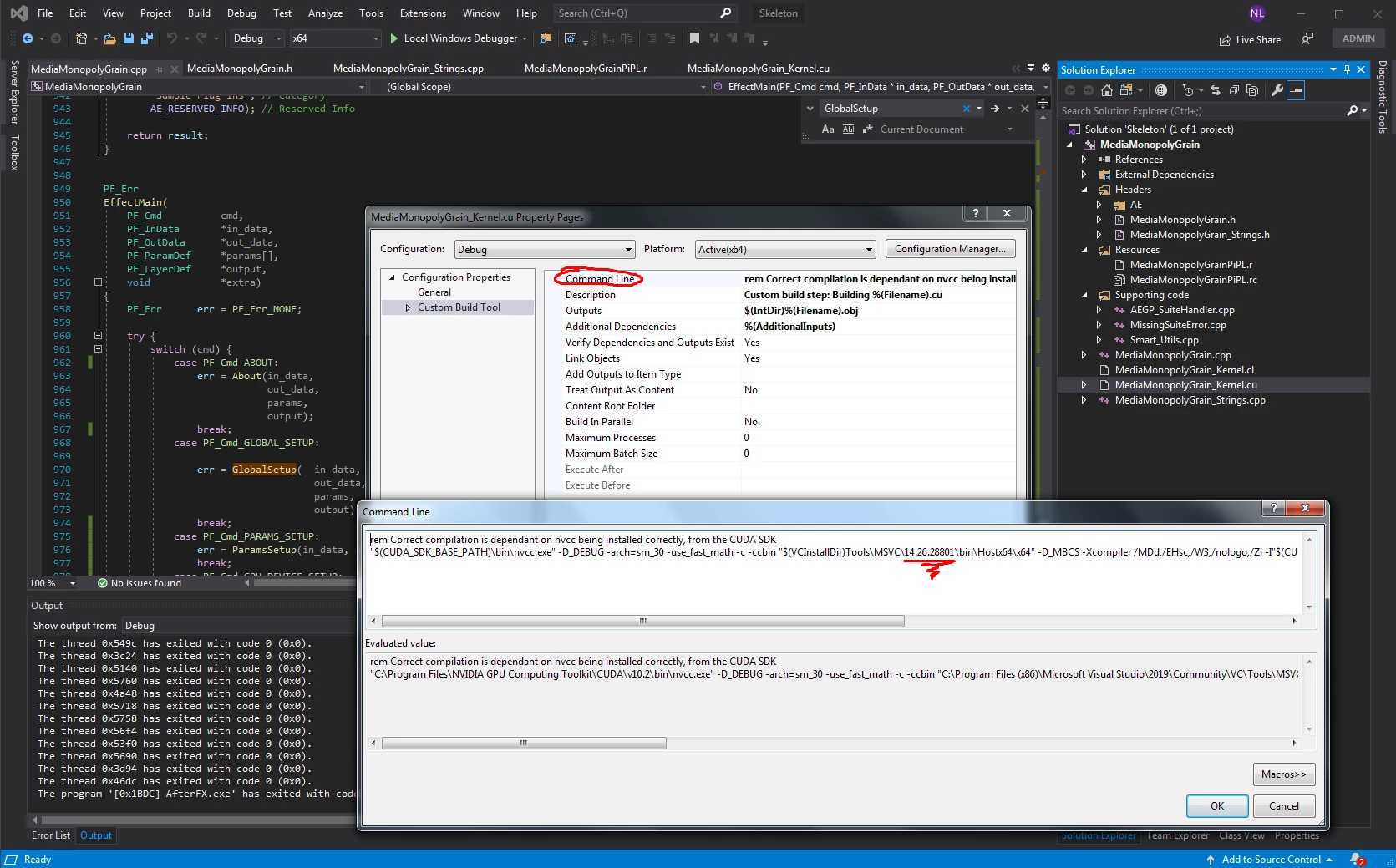

It looks like the build fails at the custom build stage of the .CU files.  I was originally using CUDA SDK v11.1 but this was failing because of the arch=sm_30 argument in the custom build instruction.
Dropping back to CUDA SDK v10.2 resolves the architecture failure, but I'm seeing this in the build output in VS2019:

Digging deeper on that error looks like the build is failing because the custom build stage returned an error.
Any ideas?

Correct answer Nathan Lovell_52
James,

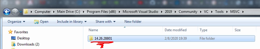

This is likely because of an incorrect MSVC version in your .cu compile options. Sometimes by default it can put in the wrong version of this, so double check which version you have installed and update the .cu file.
-Nate

Hi Nate,
Exactly right.  Working fine now.
