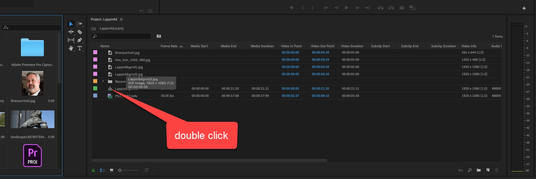

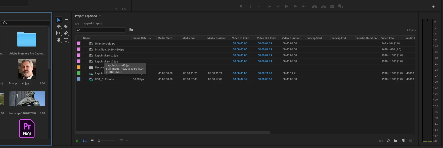

    Thank you for responding but I am afraid, I must have stated this wrongly - sorry. I am referring to the PR file itself. When I open other PR files they open in the timeline. I thought that is what is called the project file!!
    The file I am referring to is the file that opens up all the sequences in the timeline. It just doesn't open in the timeline showing all the sequences like it did before and others do too. I have attached a screen dump of it.
    Hope this helps - thanks again for responding.

    February 21, 2019
    You don't open a project file in a timeline.
    You open the project file, and it contains all the sequences, which you can open with a double click.
