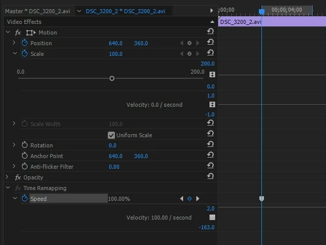

Can someone please assist me in scaling my video larger between two keyframe points?
I simply wish the video to start to zoom in from a starting point and then end at the next point.  A simple issue, but does not work for me.
Here is what I have done:
1.  In the effects panel, clicked on adding a Scale keyframe as the starting point.
2.  Further in the timeline, clicked to add a second keyframe and then dragged the Scale slider/number to the right to increase it.
See the image below of how it looks.
This does not work as the video simply does not zoom in at all.  The video plays, but it is as if I have done nothing.
What could be going wrong here please?

Hi Ann,
Seems not to work for me, unless I'm doing it wrong.
1.  I have removed ALL keyframes from scaling, position and Time Remapping
2.  Added the first Time Remapping keyframe
The 'Speed' option turns grey after that and I cannot change the speed at all, up or down.
is there something fundamental that I'm missing here that is somehow locking these options from working at all?  To my mind it should be simply adding Time Remapping keyframes and adjust the speed.  Starting at speed 100% and then ending with Speed at 300% for example.
What am I missing here please?

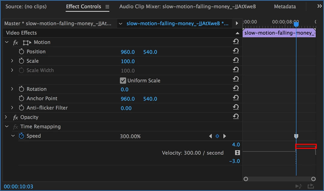

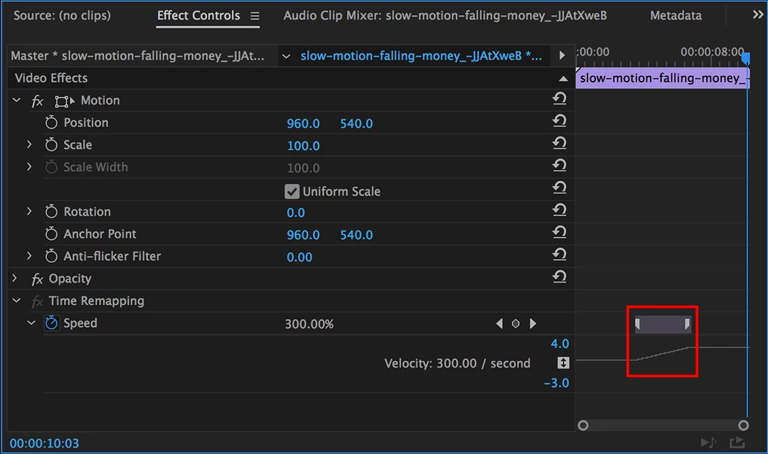

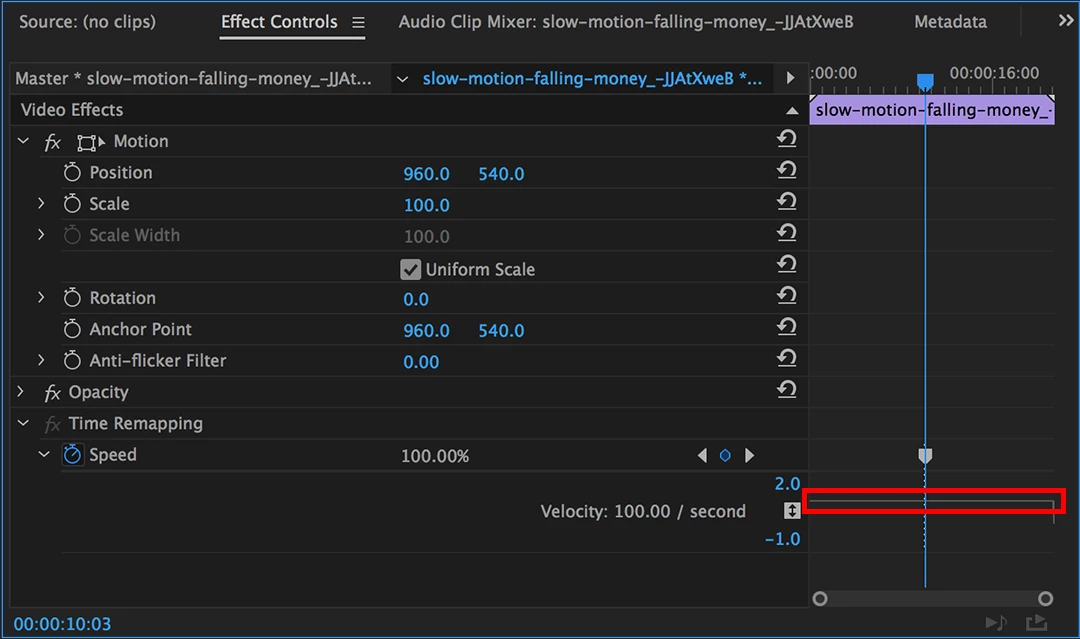

Enchanted_socialite16B7
August 15, 2017
The horizontal line (rubber band) across the timeline view controls the speed of the clip.
Set the Time Remapping keyframe, then click and drag the rubber band to the right of the keyframe up; this will adjust the speed.
If you want to create a speed transition, drag the left side of the keyframe to the left or the right side of the keyframe to the right. The gray area between the two points indicates the length of the transition.
