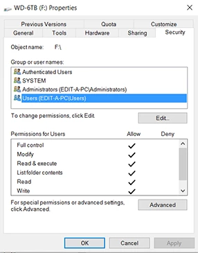

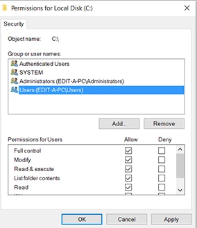

WHMB TV40
May 25, 2017
James,
Thanks for the troubleshooting steps.  I checked these on my system and no files are being created in either of the directories you mention in your steps.  I have double checked permissions for both my boot drive (C:) and scratch disk drive (F:) and as far as I can tell I have the correct permissions set for both.  (See below)
