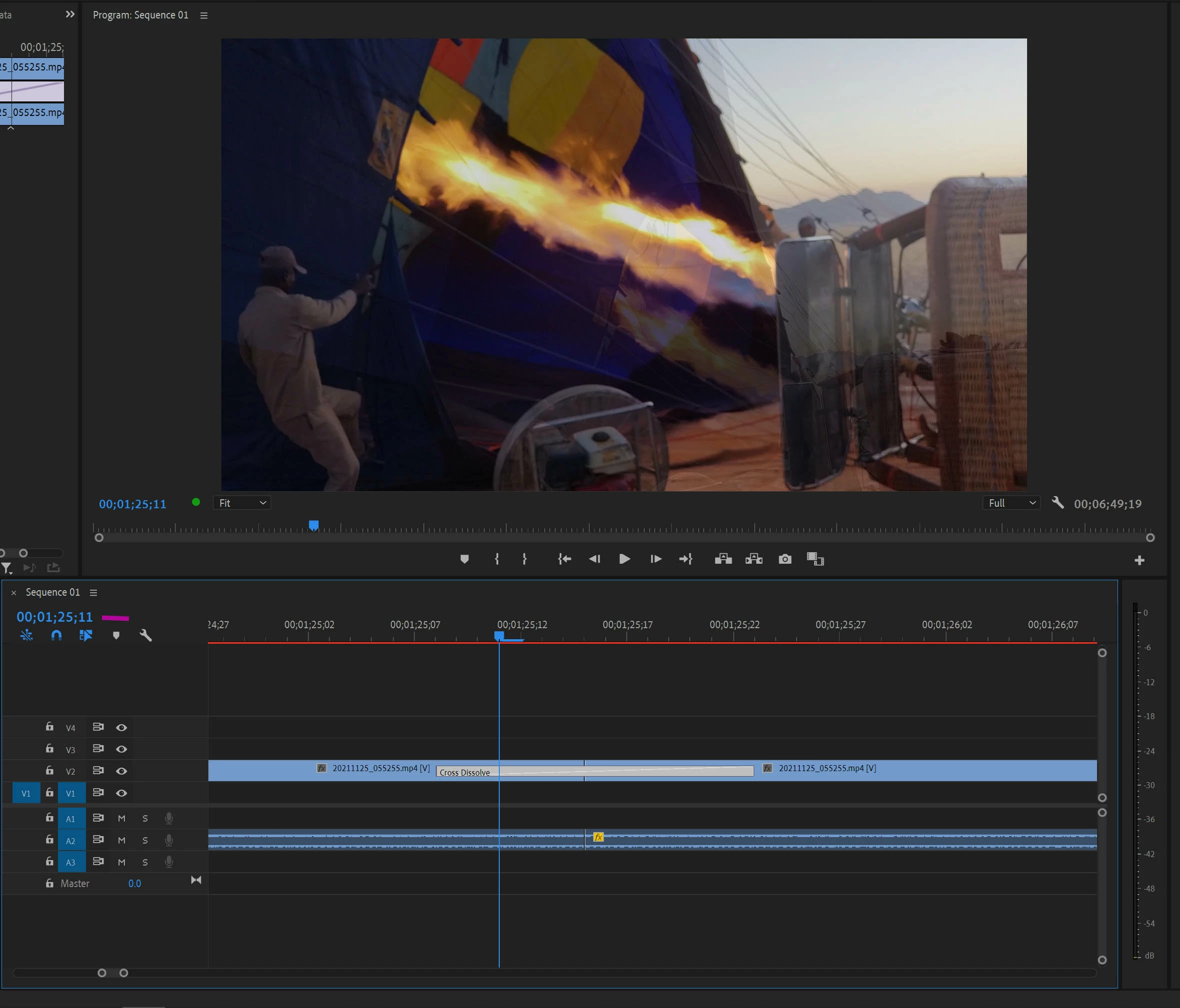

I had a long clip of inflating a hot-air balloon during which I zoomed out and panned up the balloon to show it inflating.   I decided to shorten the clip by cutting it before the zoom and putting the two pieces - let's call them A and B -  together with a 15 frame cross-dissolve.    When I played it back I noticed that it looked like it "stopped" during the dissolve, and close inspection showed that it did -  at least in the 'B' clip.

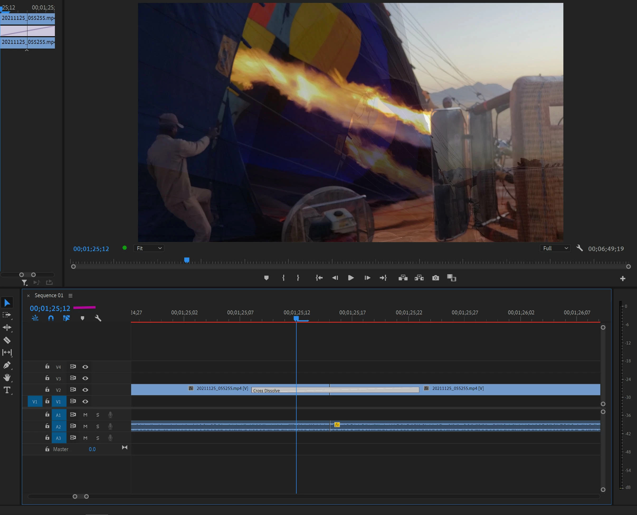

In the attached images I show 3 frames of the dissolve.   The flame in the A clip (the top flame) changes in each frame.  But Premiere Pro uses the SAME frame for all three images in the 'B' clip, as you can see from the bottom flame.   This makes it appear stuck when you play it.  What causes this and how do I fix it?
Thanks in advance.
Peru Bob
