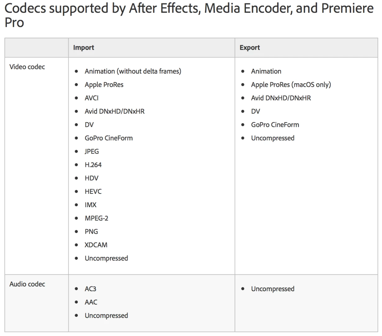

Premiere Pro 2018 stopped supporting some codecs of the known Quicktime 7 era, here is the list because AVI is not in the list of supported codecs.
Dropped support for QuickTime 7 era formats and codecs
A solution would be to transcode your videos, maybe it will be many but there is no other. Here is the HandBrake, which is a transcoder that can be useful for you.

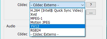

You have to mention the codec with which Bandicam is configured.
If you are using YV12, choose another one, because you will get the message "Unsupported format or damaged file"

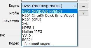

I was using a H264 nvidia video codec and PCM audio one:
From the list that byroncortezh has provided, I can see that there's a H.264.. I guess that's the issue, right? Any suggestions which codec I should use best then?

Unfortunately Premiere Pro is not compatible with the Nvidia NVENC screening codec. Have a test transcoding a video file with HandBrake and then import it into PrPro to see if this solution will work for you.
HandBrake https://handbrake.fr/
