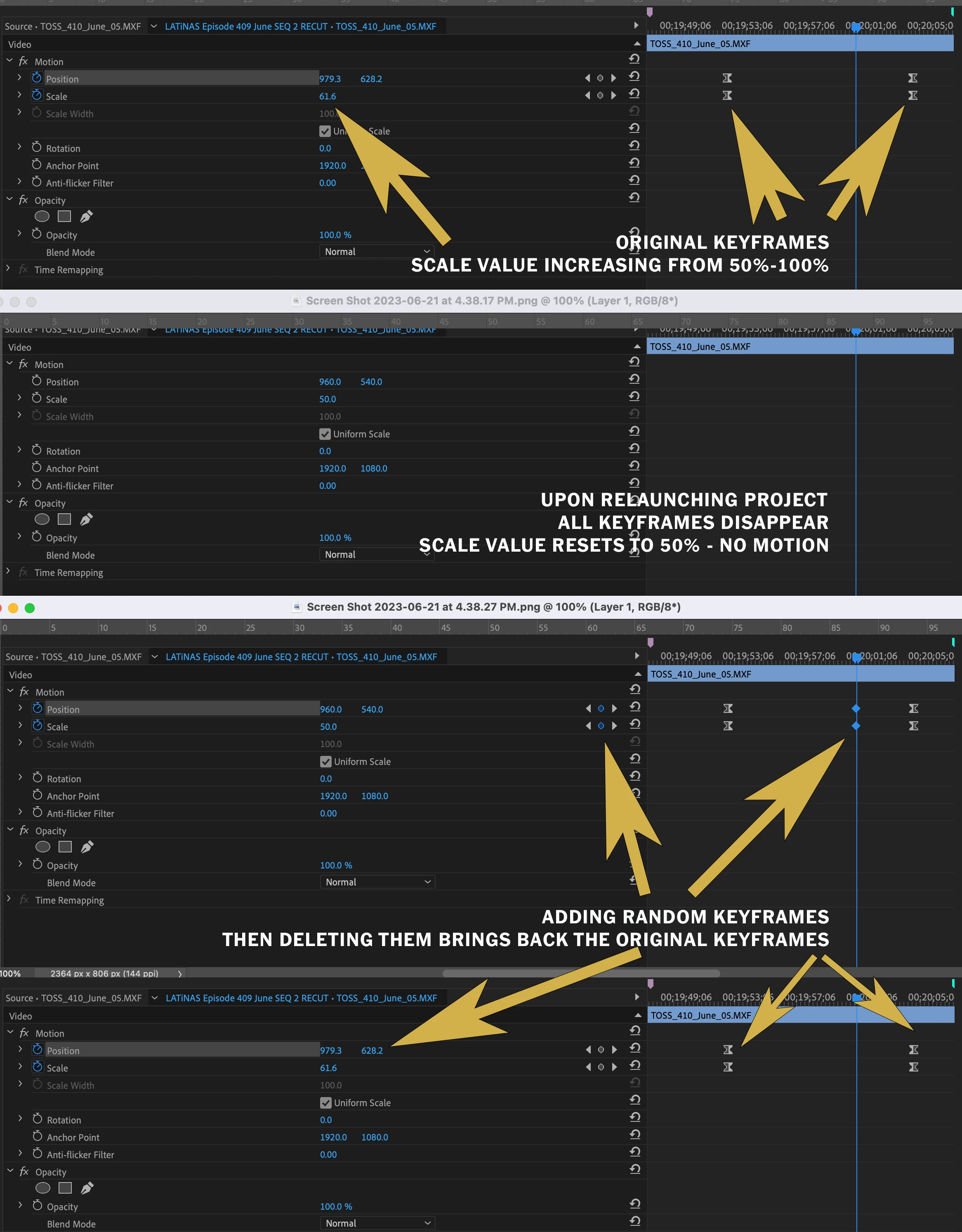

SylNYC
Jun 21, 2023 9:04 PM UTC
For the past 3 days I've noticed Keyframes added to an object (video or still) in Edit Controls (Motion, Opacity, Effects - like Gaussian Blur) disappear upon relaunching the project.
Any added Keyframes defaults to a random value for ex: Opacity set to 50% resets to a random 35%; in Motion tab: Scale and Position reset to the first Keyframe value, or 100%; Rotation set to 5% resets to 0%.
The only way to return to previous Keyframes is to randomly adding a new keyframe anywhere in the Keyframe window - which makes the original Keyframes and their values re-appear, then removing the newly added keyframe.

I tried making a new Sequence, a new Project, in both Premiere Pro 23.4.0 and Premiere Pro (Beta) 23.6.0. to no success.
