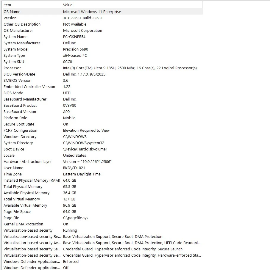

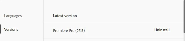

Adobe Premiere Pro version – Newest version (see attached "latestest version of Premiere Pro"
Operating system – See attached "my computer informtion"

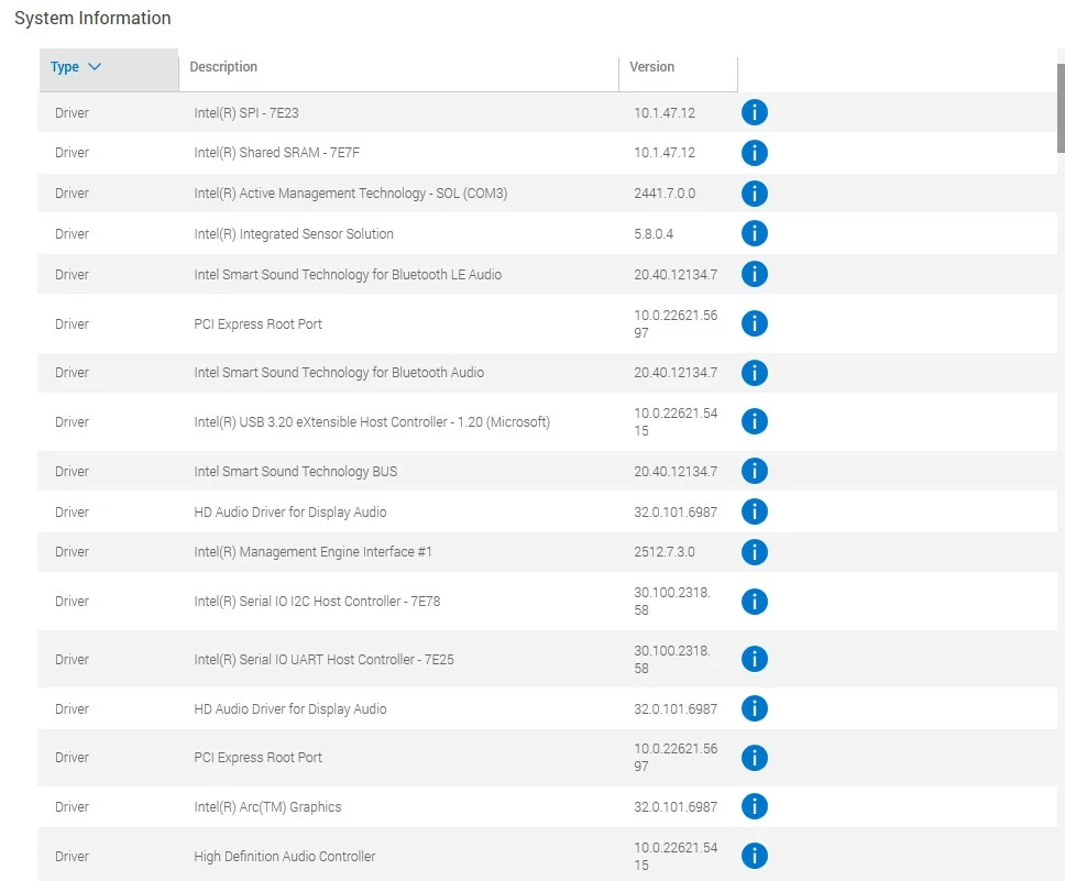

GPU driver version (Windows only) – Attached

Jamie, my IT actually had to uninstall and reinstall the Nvidia driver at a previous older version for it to work. The newest version is not available yet through Dell. Seems like that solved the issue.
