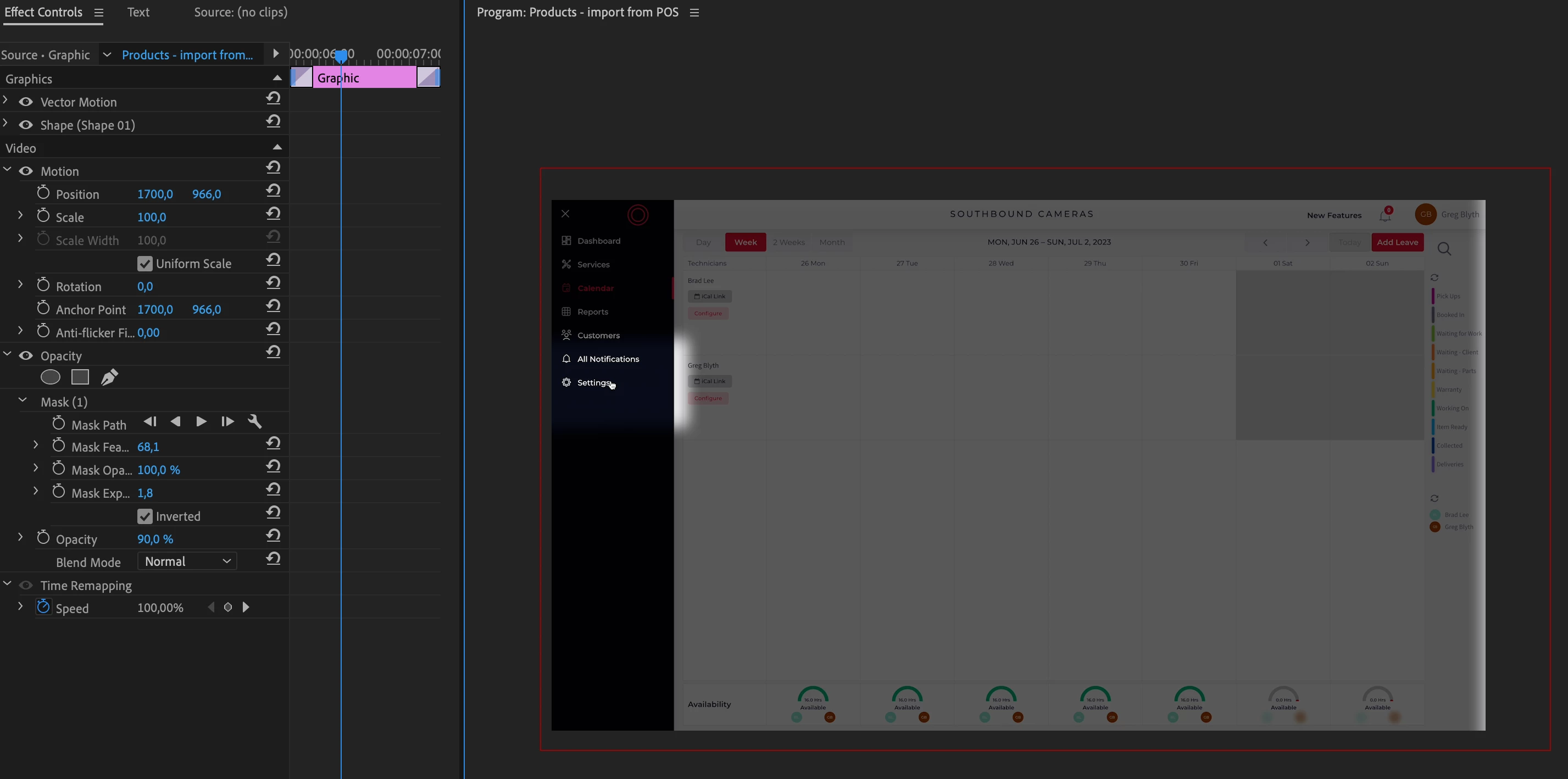

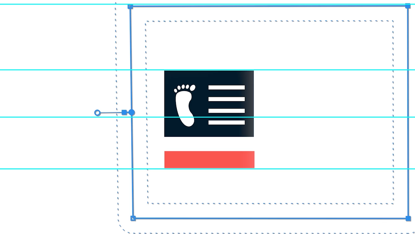

Why would this happen at all?
It makes no sense that using the mask now also feathers the edges of my layer -_-
This premiere pro version has just been riddled with the most weird bugs I hope 2020 is better.
Anyone know of anyway to fix this?
Tried in the attached image, placed the mask OUTSIDE the image, used feather, and the image is still feathering. Why Adobe -_-
    Correct answer davids58395606
    Turns out, turning off linear compositing in sequence settings fixes this. Not sure if I explained it properly maybe why you say it's normal but when feathering a mask, the layer shouldn't be getting feathered nowhere near the mask.
    Anyway! This fixes it

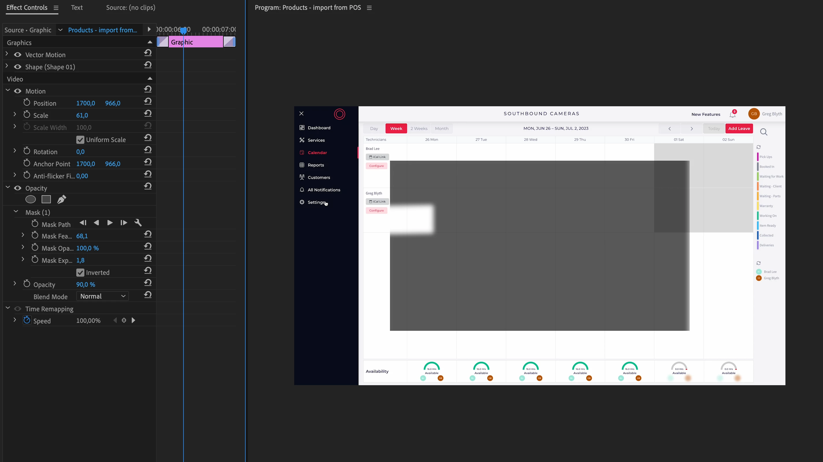

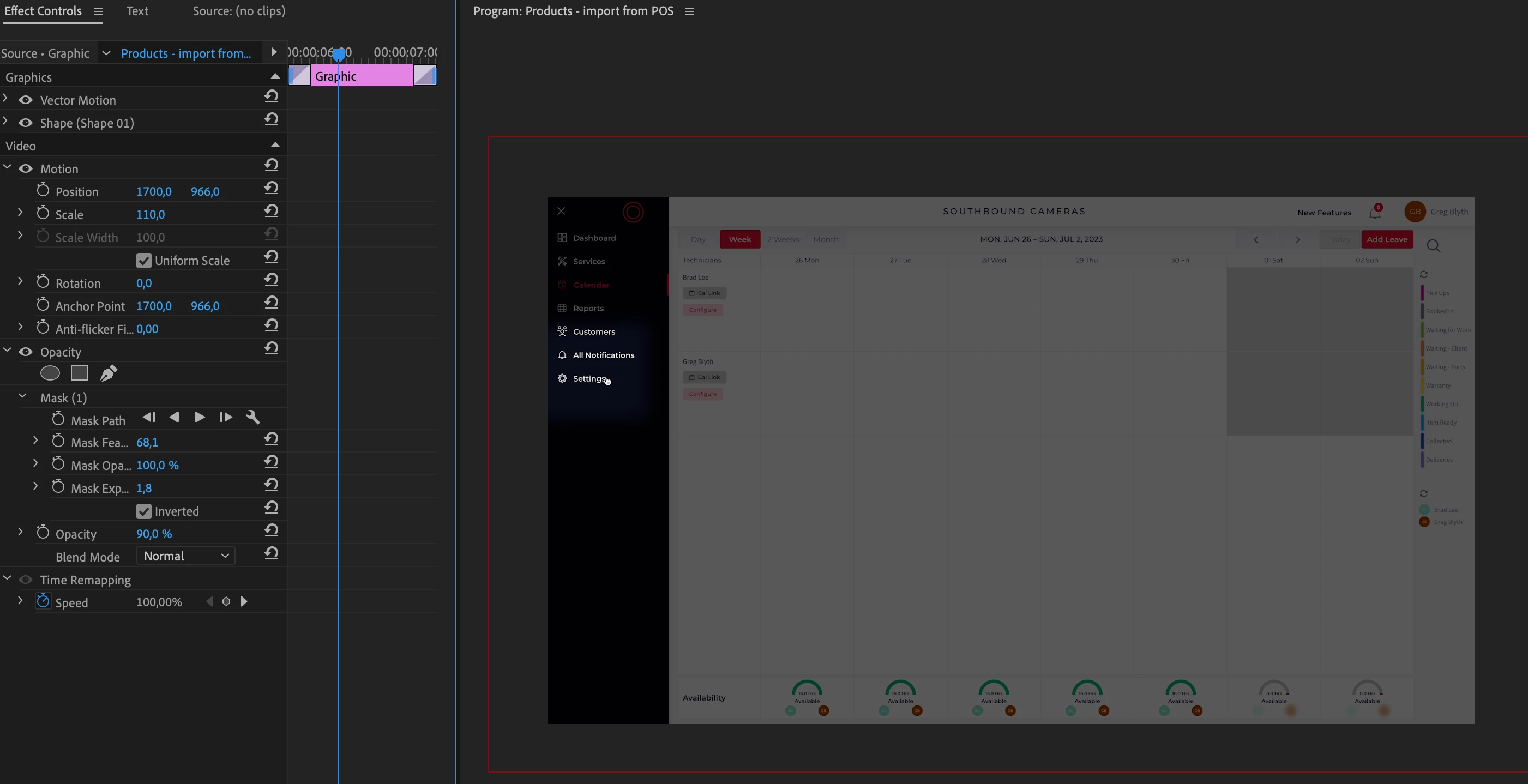

    I was having the same problem. I created a rectangular shape and extended the borders beyond the screen, added a mask and inverted the opacity. Then when I feathered the mask, the right edge of the screen was also feathering. See screenshot:
    But then I adjusted the SCALE to 110 and it pushes the screen edge feathering out.
    Pulling the scale down I can see the full rectangular shape, and the outer right edge is clearly feathered (along with the mask inside the rectangle) while the other outer edges are not. Strange.
    Hope that helps you.

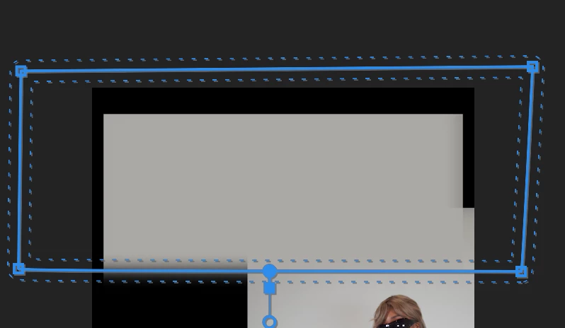

    I have run into this on countless projects and the linear compositioning toggle doesn't fix it. It always happens on the right side of whatever I am masking. See screenshot, the feather is WAY closer on the left but the right side is feathered despite the mask box being nearly out of the frame.

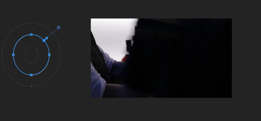

    I have the same problem, havec you figured it out by any chance?
    In my screenshot you can see the problem, the vertical feather is what I want, but for some reason it's bein feathered on the right side even though the mask boundaries are far outside the frame.

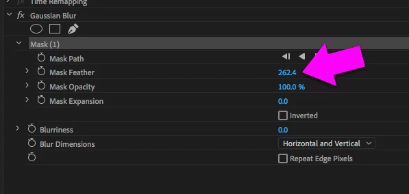

    Peru Bob
    September 25, 2019
    Can you post a screenshot of the timeline and the effects panel?
