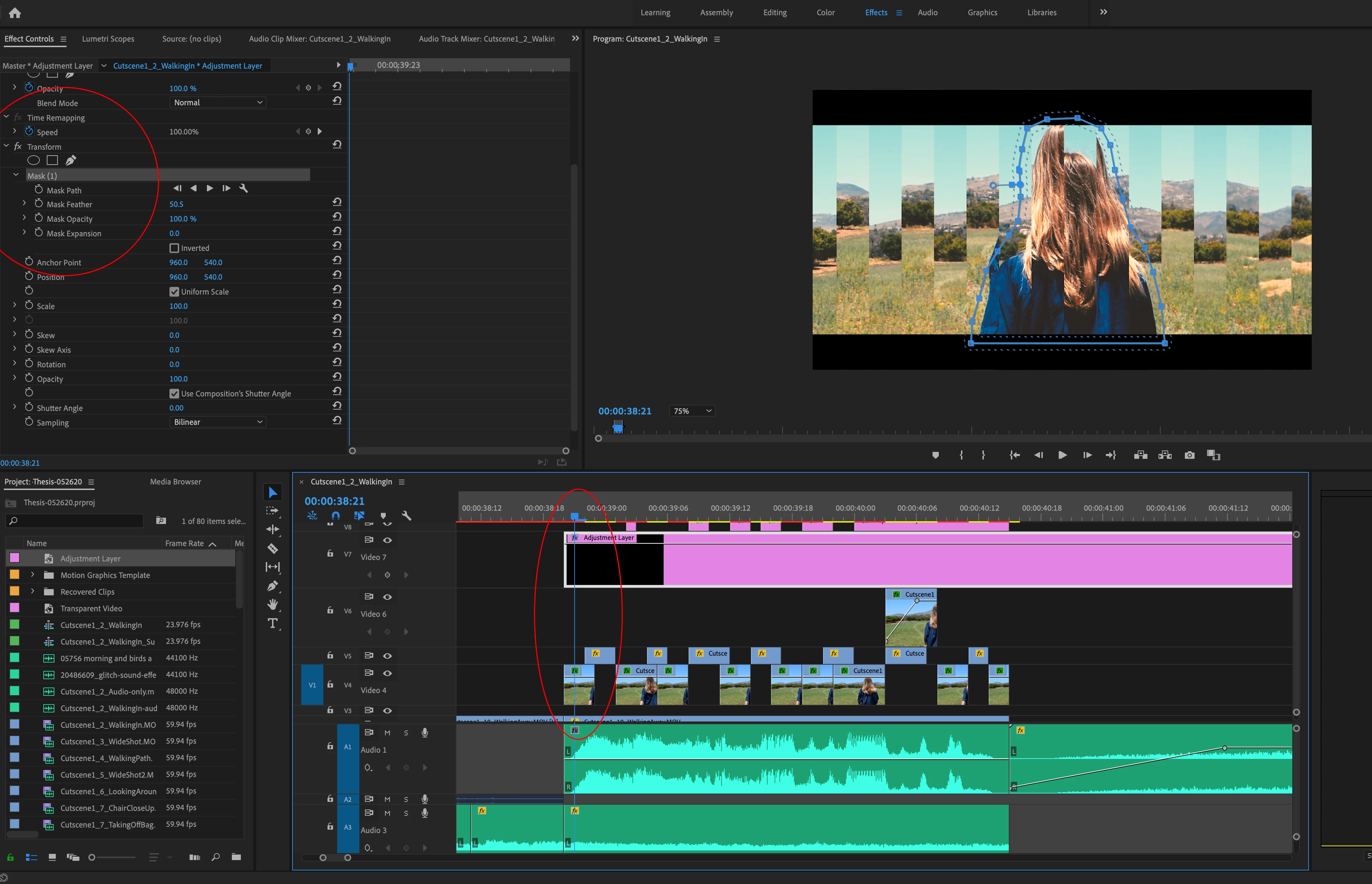

However am I doing it the correct way? See attached pic.
I applied the Transform effect on the adjustment layer as you suggested. But it's not applying the mask on the V5 and V4 tracks below the adjustment layer. The V4 clip has the wave warp effect on it that I want to mask onto the figure only.

while i could use the wave warp effect on the adj layer itself, where the mask should work, the challenge is I have many different variants of the wave warp on that V4 track on many different clips, yet all of them share the same mask.
in my perfect world, i would have just one mask (one instance of it) that i can tweak in the adj layer, which would then control all the clips with the different wave warps in that track. otherwise i would need to copy/paste the same mask, and multiple instances of it, onto twelve+ different clips. ugh.
