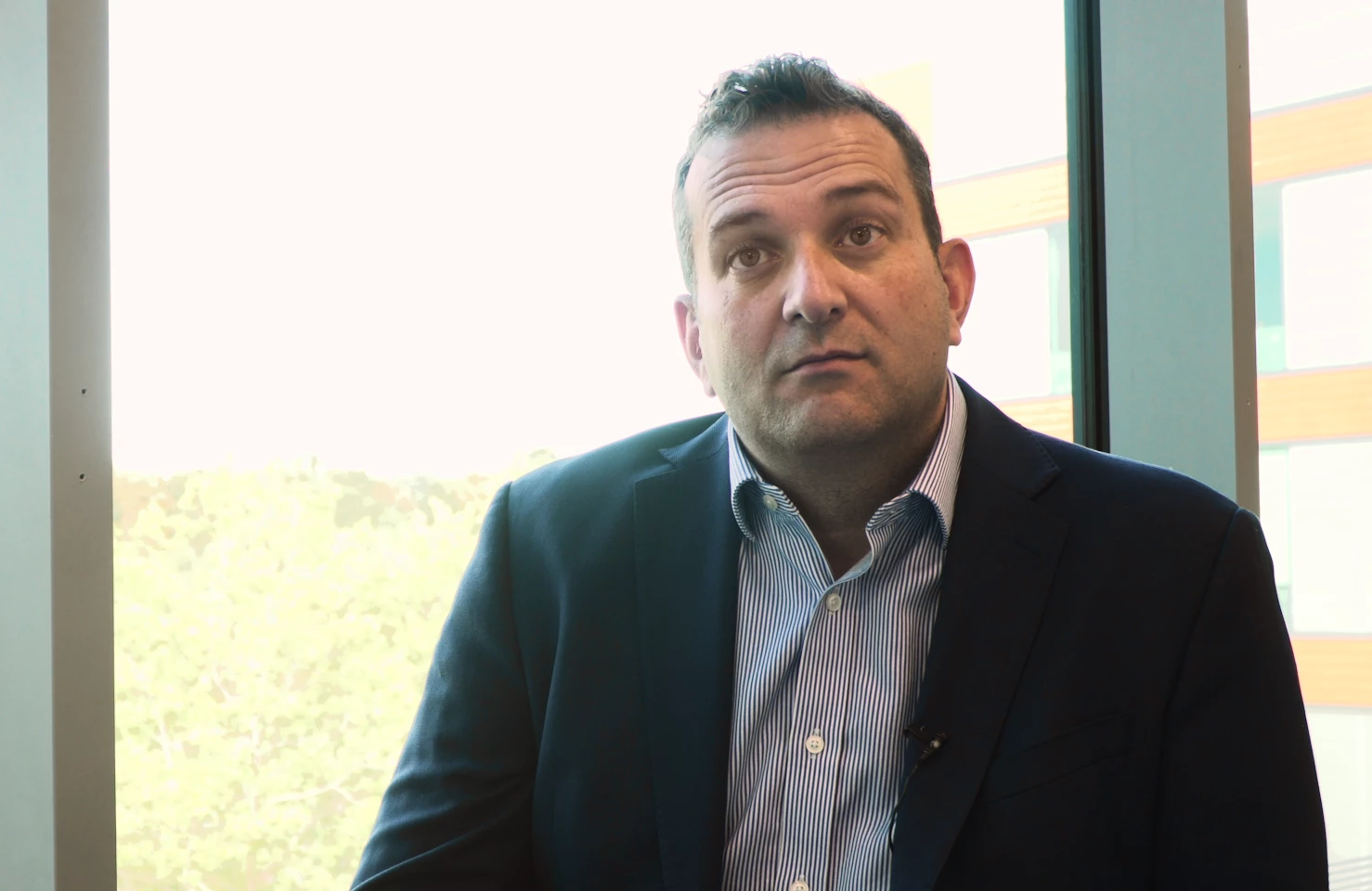

First, this is a salvage operation all right ... the outside foliage and buildings are just gone in at least one if not multiple channels, complete hard-lined clips. If you need a complete replacement of the outside, that's ... another expert. And bill. But, the interviewee can still be salvaged as needed.

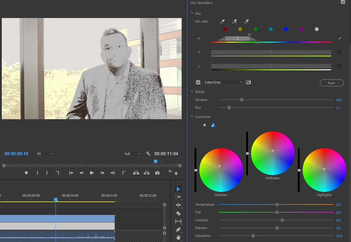

Now ... there was still an issue in the shadow skin tones especially under the chin and to the viewer's left side of the neck. Greens ... a Very Bad Thing in skin. The quickest way to get at that is an HSL qualified selection ... so off to the HSL tab,  and used the eye-dropper to select the left side of his neck then setting the visible mask option to Color/Grey and 'on'. After playing a bit, I turned off both Luma and Sat, as I got the best coverage of his neck without them (and wasn't worried about anywhere else this key would affect) ... and moved the Denoise and Blur settings up so as not to get any visible edge or chatter while moving. I switched the color wheel mode to the three-way option, and adjusted the wheels as you can see ... pushing the tones farther to the 'skin' type of orange in the shadows than mids or highs, as that seemed to get the best look with the mask off. I added a bit of contrast to the keyed selection area and pulled saturation back just a bit ... it's shadows mainly, it's better to have visible luma contrast and less saturation in shadows. More "natural" looking.

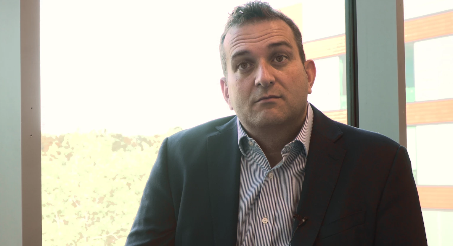

Here's where I was at this point ...

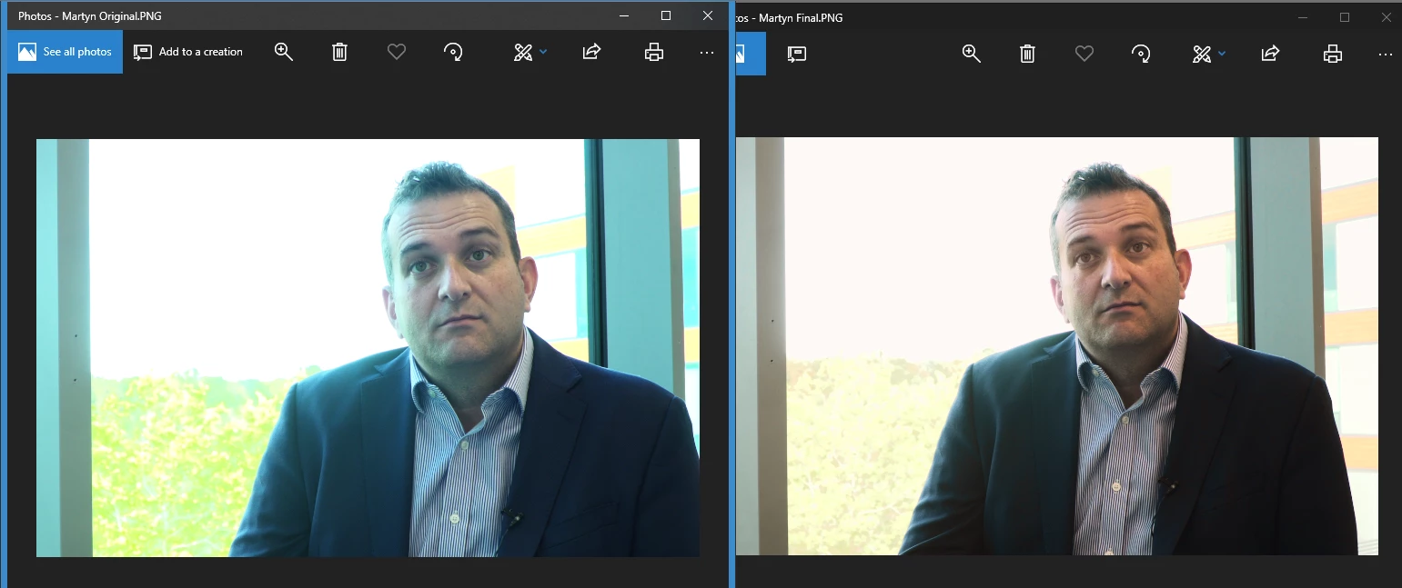

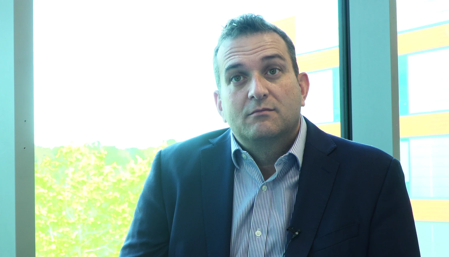

Final result:
