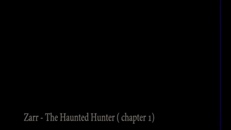

When compiling a video with music, videos clips and transitions, I am getting a thin vertical line at the very beginning or end and sometimes both, of my composition.
The line is at the very edge of the frame and is usually blue, red or white. It appears for a few seconds then disappears.
Any ideas what might be causing this?
Thanks
    Correct answer excited_Genie16B8
    The export does have the line and in fact the live project shows the line as well.
    I removed the 'dip to black' transition and the line disappears at the beginning of the project.
    When I remove the 'dip to black' transition at the end of the project, there is a purple band that appears on the right of the screen.
    I haven't exported that version to see if that shows up in the finished video.
    I have a feeling it has something to do with the transition.
    OK, that clears it up.
    Don't use Dip to Black except when you want to go to black between two video clips.  Use the Film Dissolve for opening and closing fades.
    Also, click the wrench under the monitor and select Overlay Settings>Settings... Uncheck the "End of media/sequence Indicators" box.

    Show us.
    raoul450Author
    January 13, 2017
    The lines almost seem to appear and disappear with the beginning and end transition I'm applying which is usually 'dip to black'.
    January 13, 2017
    Do you see this in the export?
