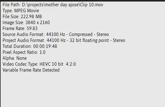

I'm assuming you're working with media from a phone. I can see that it's in the HEVC codec (really bad for editing) and also has variable framerate. It's also high framerate. That combination tends to create some insanity inside of Premiere that will also make it into the export. You need to use a program like Handbrake to correct the variable framerate. The resulting file will be an H264, which is also not a great editing codec, but easier to decode than HEVC.
VFR Info:https://www.reddit.com/r/VideoEditing/wiki/faq/vfr
Handbrake: https://handbrake.fr/

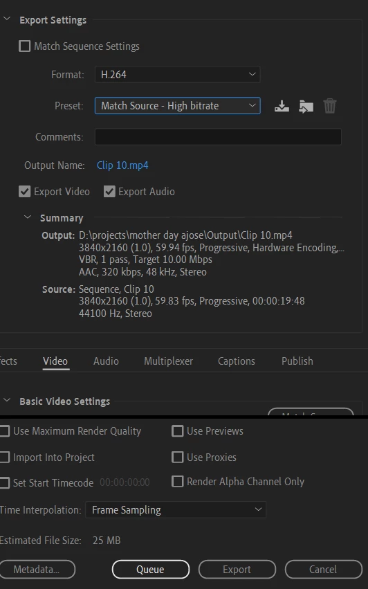

As far as your export quality: 10 Mbps is very low for a 4k encoding. You can try some of the 4k presets to get a better sense of what the target bitrate should be. For H264 I'd usually be doing like 50/60.

Please find the attached screeshots of export settings and video properties.
